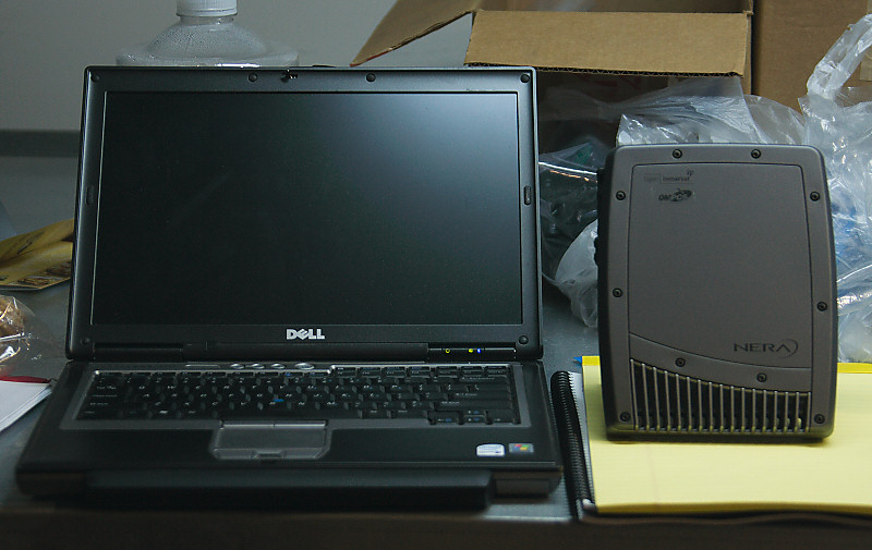

OK, sorry for the delay, it took me a few days to get these shot and posted.

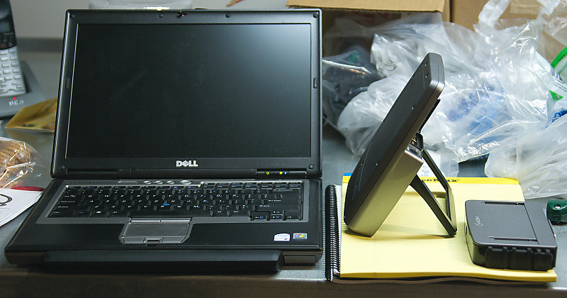

Here's the Nera Pro 1010 next to the laptop. This is the entire unit, terminal and antenna.

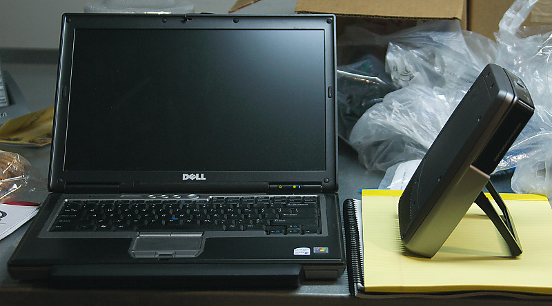

Side view, laptop and 1010. This is the entire unit, terminal and antenna.
This is the 1010 seperated into its component parts. Antenna is next to laptop with its stand extended. Terminal is on legal pad. The terminal connects to the antenna with a DB9 cable.
I'm installing these components now. I'll post an update in a few weeks once we've done some field trials.

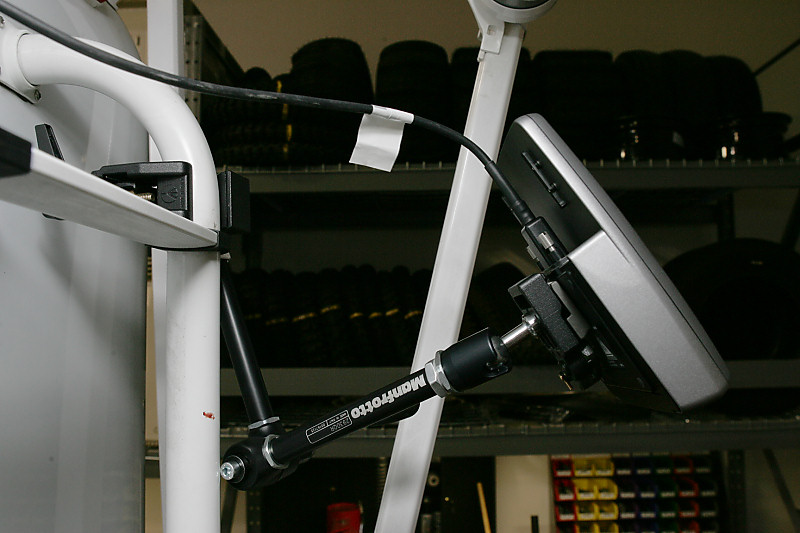

Here are some ideas on mounting. Our situation is a semi-permanent mount. The modem will be mounted with other electronics. The antenna will be deployed when we want to use the system.

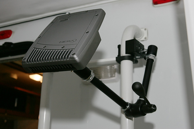

Here's the antenna in a typical deployment position.
The mount is a Manfrotto super clamp and a Manfrotto universal hinged arm with quick release. I use the same quick release system on my camera bodies and lenses, so I can make use of this clamp/arm system in a lot of ways.
If we've got the rear awning deployed, I've got another 3 meter IP67 DB9 cable that I can use to move the clamp/arm/antenna system to an open sky shot.

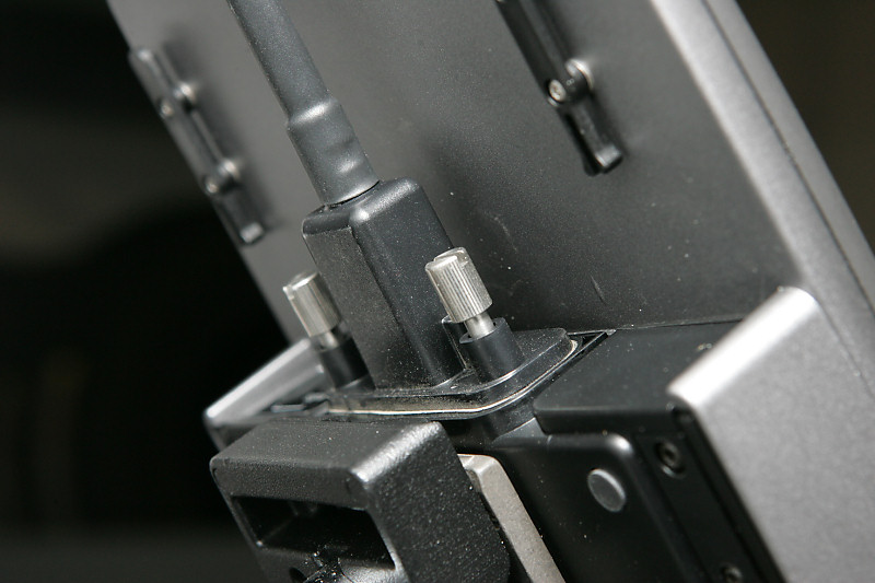

Here's a closeup of the IP67 DB9 connection on the antenna.

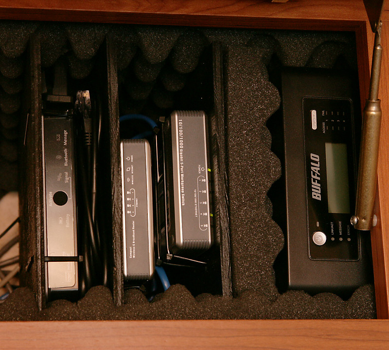

Lastly, here's the electonics bay partially loaded. L to R: Nera Pro 1010 BGAN terminal, Linksys compact wireless G router, Linksys gigabit switch, Buffalo 2 terabyte RAID array (1.5 terabytes in RAID 5 configuration which is what I use).
This is a reasonable setup for mobile digital photography. It includes a RAID 5 array for storage, gigabit switch for high speed tranfer from camera/laptop, wireless router to allow editing/email/printing/etc. from anywhere within range. We carry a spare drive for the RAID array.
Our strategy for offsite backups is to take along a batch of bare drives and a USB drive frame. When we've got a few hundred gigs of data we'll copy them off the RAID 5 array and ship the bare drive back home for safe keeping.
If you are going to do mobile video editing you'd probably want to carry a high speed drive array for the edit work. The RAID 5 array would be good for backup, archive and offline edit files.

Thank you so much for posting this info. Have you conducted any data transfer rate tests?
