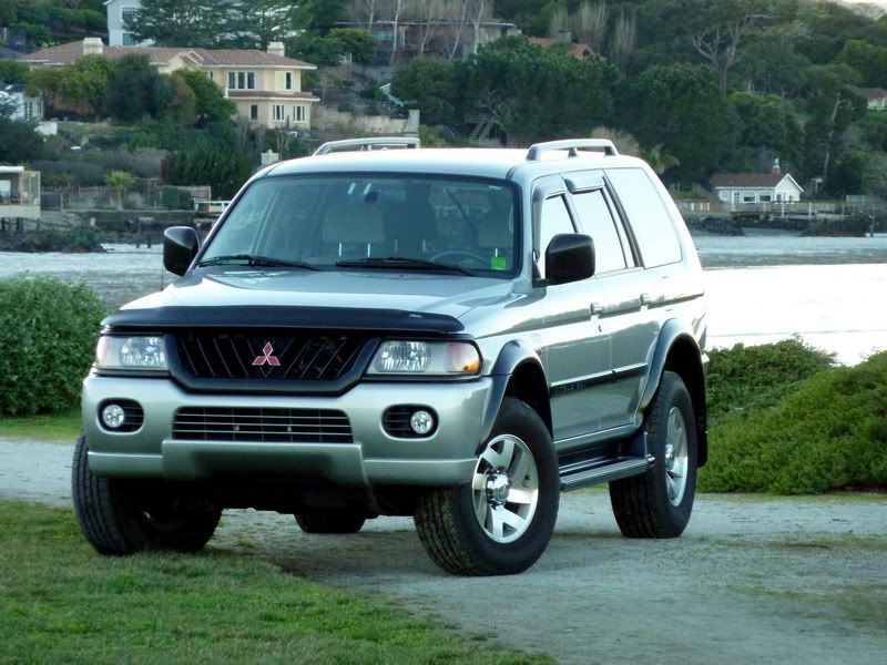

Sports look like this, and this one is an XS as well.
Being that you said its an XS, i would say its a good chance its a sport. I dont believe they made the full size montero in the XS trim. The full size montero's have a higher roof line similar to a land rover discovery. As with any vehicle, maintenance is the key to reliability. Others will chime in with more detail but a few things to consider...
