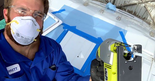

Step 4 Cut A Hole In Your Van
Well as everyone who has done it knows, the first cut is the deepest.
Bought the Maxxair 7500k and prepared to install it.
I found this video the most useful and followed it: Painters tape and shop towels all around the top in order to catch most of the shavings.
Box underneath to catch the shavings and the 14" x 14" square of sheet metal.
The layers went: Van metal -> butyl tape -> fan bracket -> sheet metal screws -> lap sealant -> actual fan
I simply dangled the wires underneath and went about my day.

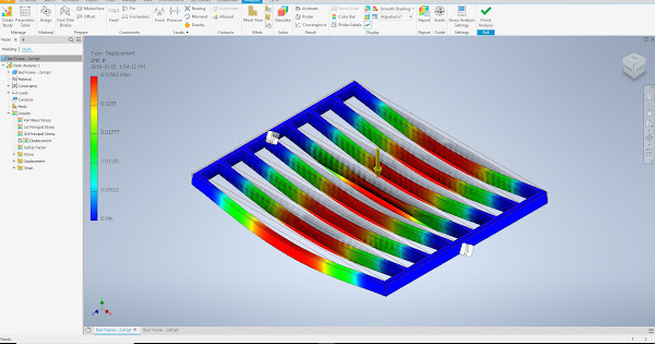

Step 7.5 Realize Your Bed Frame Is A Bit Too High
After we put the bed frame in place we figured out that it could go down an inch or two.
After looking at options, I've even put the bed frame into a FEA study to see deflection of 2x6s vs 2x4s.
Results in the photos, but here's the summary:
4x - 2" x 6" - 0.013" Deflection
5x - 2" x 4" - 0.043" Deflection
6x - 2" x 4" - 0.038" Deflection
8x - 2" x 4" - 0.030" Deflection
So as of right now I'm going to have family dinner tonight and talk it over with Dad and Leah, see what we can figure.
Is 0.030" acceptable and safe over a year's worth of sleep and abuse?
Is 0.100" acceptable and I'm not worrying for any reason?
I've seen people use other materials such as steel too, but I like the woodworking aspect. Screw plywood in and such.
Any one want to weigh in on this?

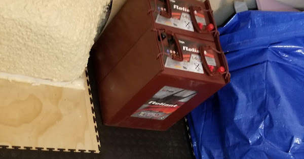

Step 12 Buy and Install Batteries
Originally bought 4 Trojan T105 6V 230ah batteries to run in series-parallel.
Fantastic! $1000 CAD and we have 460ah to allow us to run off grid for 4 days without power!
Unfortunately we decided that the off gas, maintenance, spill possibilty, made AGM the correct answer.
So I took back the batteries, and bought new ones.
So even though we had to downgrade output and increase cost, we got a solution I feel good about.
2x Trojan L16-AGM batteries 370ah 6V, wired in series.
Motive L16-AGM | Trojan Battery Company
These are BIG batteries, as your can see when they are in the bed of my truck.
Plus they were a total of $650 CAD and trust me, I shopped around a ton, including the US and the internet. Ended up buying local.
Also, over 100 lbs each, so fitting them in and out of the battery box was a lot of lift with the legs haha.
When I'm looking at other builds, it looks like I am significantly more worried with crash rating, but I really don't want 250 lbs moving at all.

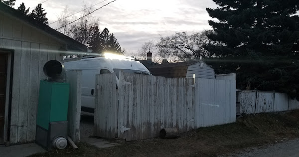

The morning before I flew out, we wanted to move the van from my house to Leah's place so it would be easier for her to work on it for these three weeks.
This invlolved paking EVERYTHING up and loading it in, which was quite funny.
We'll have to do the reverse on Nov 24th or so, but it'll be fine.
