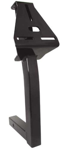

So that brings me to the front. If I were to have a front bumper built with a reciever hitch, I could have an attachment that could hold the wheel. The problems I see is that it would obsruct the radiator, block possible light mounting locations, and would likely interfere with any winch installations. It would however offer a lot of deer and elk protection, and could look pretty cool.
I put a receiver in my front bumper and found it very usefull. I never mounted a tire but some options I've tried:
Winch tray
upright to hold the front of canoe
tray to hold clay pigeon thrower
ice chest/ fire wood tray
At first I used a complete receiver, it stuck out ~5 inches
Then I ground it off and just use the hole now

I experimented with a frame mounted front receiver from Curt Manufacturing, with a model 31006 spare mount from them as well. It absolutely KILLED the approach angle, but when I got a custom bumper made that all got fixed and I got rid of the Curt.
Never seemed to have problems with airflow in 95 degree deserts.
