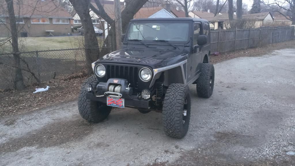

tow vehicle is an 03 rubi with 3" front and 2" rear BDS springs with a few other upgrades and a lot of aluminum. just grabbed a SWAG big hit v2 bumper, with frame tie ins, that still needs to be welded up
