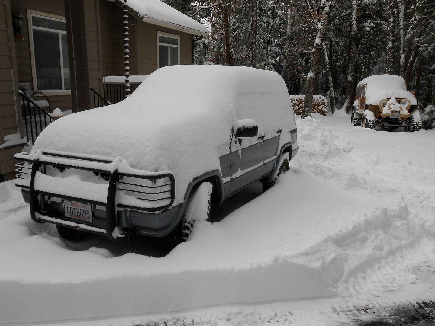

Another one of our 'winter' cars is a 1999 Jeep XJ Not-So-Grand Cherokee. This is our 3rd XJ. With the NV242, full-time, part-time T-case and the venerable 4.0L, I-6 with 3.73's gears (it's a long story); an Aisin Warner AW-4 wide ratio slush box; rear Trac Loc, front Detroit True Trac (gear driven, clutch-free, torque biasing limited slip) it is hands down the best snow car we've ever had. We've owned 14-4WD's, many of them hard core. Like yourself, many of these were 'project' rigs. It's kind of a sickness, this 'build' thing. BBW: builder be-ware.
We've owned 14-4WD's, many of them hard core. Number 14:
Of course, we brushed off the snow and drove away:
