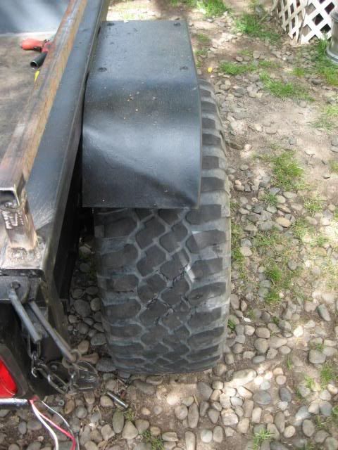

then I picked which tires I wanted first it was 33X12.50
then to match the 4 runner I went with 35X12.50
yeler
spring hanger
also added a 1x1 square tube to add to the strength of the spring hanger
and cut the square tube to let the spring move
stock springs from my daughters are 86 Jeep XJ
yeler
this is where we are today
83 Toyota axle
86 Jeep XJ springs
35" tires
pintle hook
pretty much done but gonna start on this again soon :coffeedrink:
yeler
Guess if I had to I could tow with my bumper LOL
this is what we usually take alon as far as hard boxes
these bottles are great for camping
almost sits level but it will be better when I get her all hooked up

Very cool. Love the 4Runner, I used to have a 85 that I shouldn't have gotten rid of.. Are you planning on putting fenders on the trailer? Also wonder if you may need to beel up the tongue a little for offroad travel.
yeler
thanks or the kind words about the runner
fenders um ..... no just gonna do mud flaps only cause I dont have any fenders LOL
never thought about the tongue you think I need to, I guess so or you wouldnt have mentioned it LOL, what would you suggest .... a new one LOL
