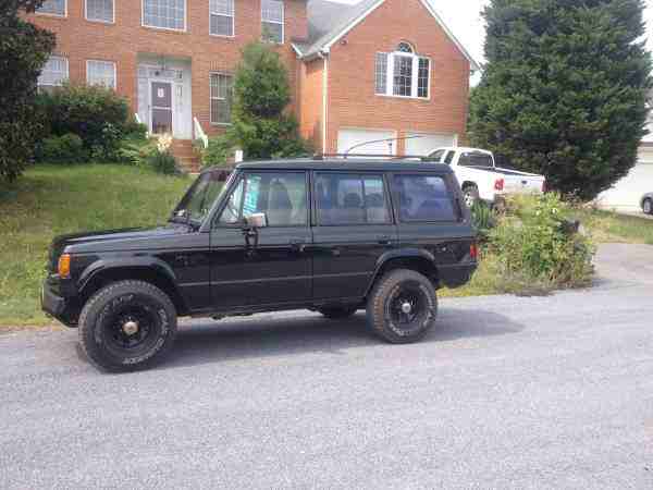

I have done a few things to my montero over the last year. Fuel injectors, water pump, intake gasket, etc... mostly trying to get what i can from the 3.0.
I recently installed a 3" 4crawler body lift, it was extremely easy and has allowed me to fit 35s with no rubbing.
Did a front bumper and I'm currently making the platform for the winch. Then I will make a matching rear bumper
I have freshened up the braking system with new calipers, pads, etc...
I grabbed some parts off of a donor vehicle such as a full interior, doors, fenders, trim pieces. I plan on installing the nicer parts this winter.
The 6.0 is currently getting ready for the install and hopefully that goes in within the next couple months.

Stock on 31s
3 inch lift on 35s

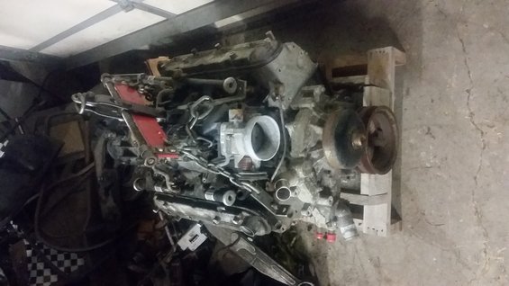

The new power plant

Still sourcing parts for the motor swap. Waterpump, crank and intake are coming from a car lsx so they are a bit smaller and should give me a tad bit more room.
Looks like I'm gonna end up using a th350 I have lying around for now. Eventually a 4l60 or 80 will be taking its place. All I need to do now is grab the conversion flywheel and engine mounts, then the fun really begins.
