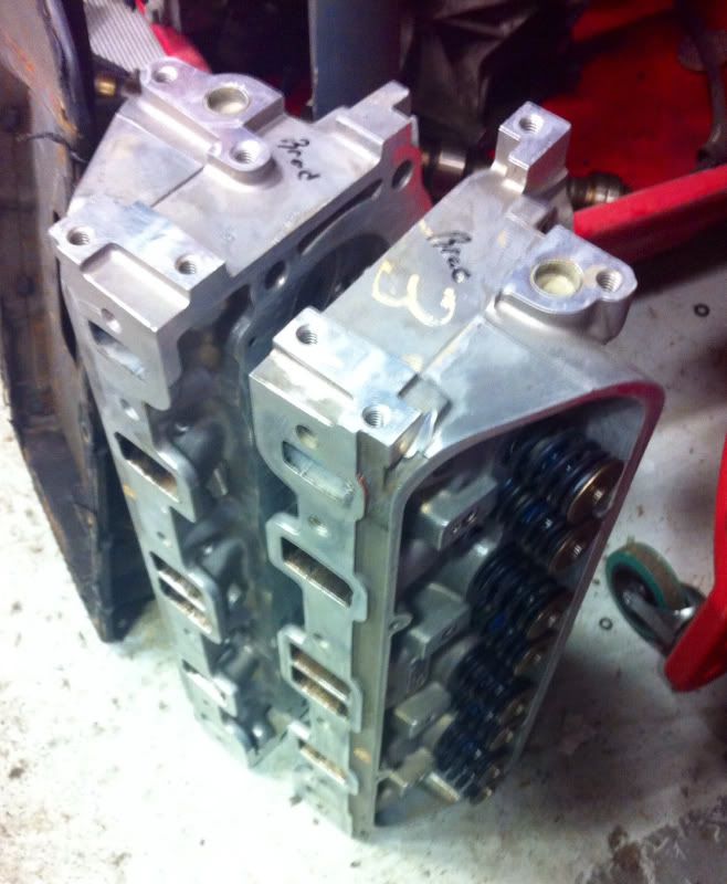

Rebuilt heads:

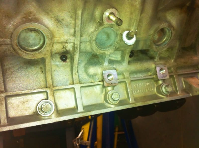

Pinned sleeves:

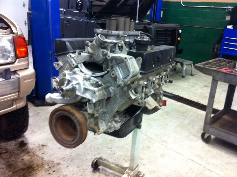

Engine ready to install:

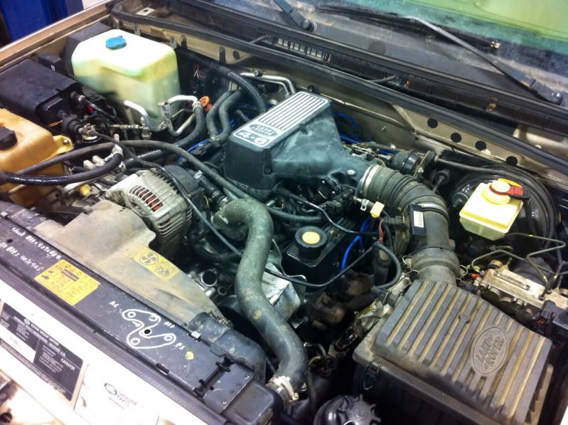

Installed (excuse the belt diagram, had to use a used radiator from another vehicle as mine was falling apart)

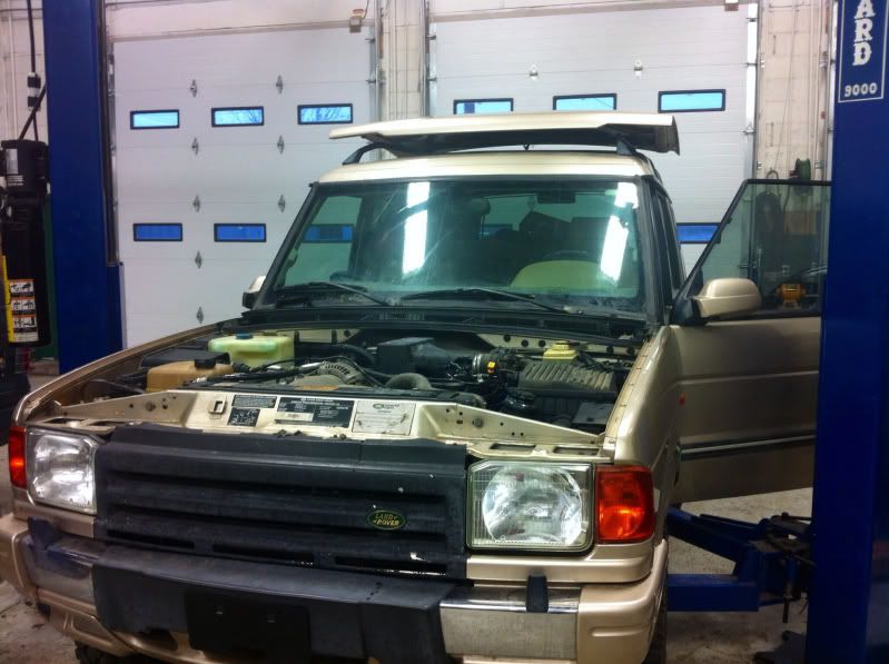

Just have to add the finishing touches.

Nice. Love to hear more about what is involved in "pinning" the sleeve?

Not sun roof protection. It's a modern take on the classic Series safari roof!
