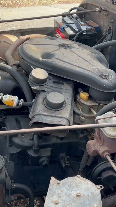

And home! As soon as it gets above 20º I will get it running. The carb needs cleaned up.

They put in a new engine 10 years ago. The Jeep has 117k miles. And they could never it going after the new engine.
There are TONS of vacuum hoses not connected, or missing. And the carb needs rebuilt. After unsticking the floats in the carb, new fuel pump, new inline filter, I got it to run for a few minutes.
The gas smells like varnish, and lots of work to be had of cleaning the tank. lines, etc. Also every hose is dry rotted.

Carb cleaning:

My father in law had a guy install a new engine. And a new gas tank. As I'm working on this thing, I'm finding a lot of shortcuts that were taken. Missing bolts, loose clamps, etc...
None of the air / vacuum hoses are connected correctly, or at all. I have a diagram that I'm working with trying to get everything hooked back up.
The Jeep sat for at least 10 years. The fuel smells like varnish.

I'm fighting with tuning, and I think I have a stuck lifter. I pulled the valve cover and all the rockers were tight. Not sure what's going on with that. It is getting less noticeable the more I drive it.
My father in law put in a new engine, but couldn't get it running correctly after the install. The mechanic he used was horrible. Most vacuum lines are missing / open vacuum ports.
After a second carb teardown, I broke down and ordered a Holley Sniper EFI kit, not yet installed.
The engine bay is a mess. Before I install the EFI, I am going to clean things up.

Holley Sniper EFI installed. I only have a few miles on it, but I'm already a believer. Holy crap, it idles so smoothly and drives like anything else that's a standard, not rough or anything like it was. It feels like a different vehicle now. INSANE.
Throttle body:
In tank fuel pump:
There is a Sniper EFI ignition option, which includes distributor, coil, and CD ignition box. Which is controlled by the Snapier EFI ECM. I will but that next.
Even Holley says buy just the Sniper EFI kit and get it working right, then install the ignition system.
