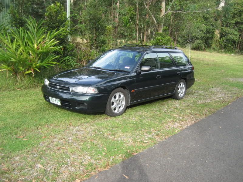

My car started out life as a standard automatic 1997 Subaru Liberty wagon. It was purchased around 2010(?) by Al at AMauto in QLD, Australia who fitted up a 2003 3.0 H6 motor and STI drivetrain. It was a vehicle I enviously watched on various forums for a few years before it came into my possession looking like this...

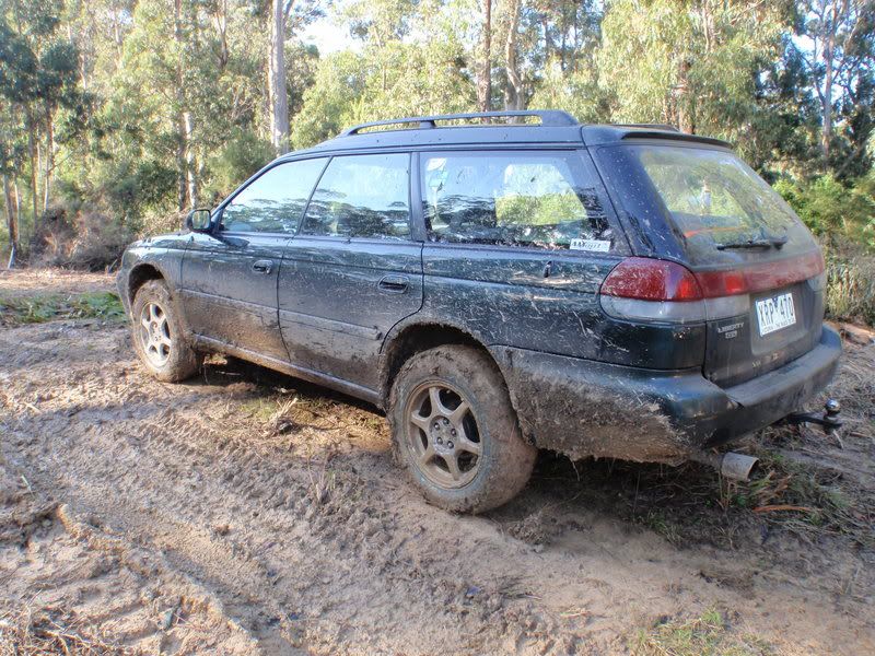

Picture from my first trip after fitting up a 2" body lift kit, outback struts and king springs, 215/65R26 tyres on stock WRX rims.

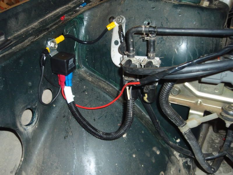

The servo's that run the centre vacuum locker fitted up.

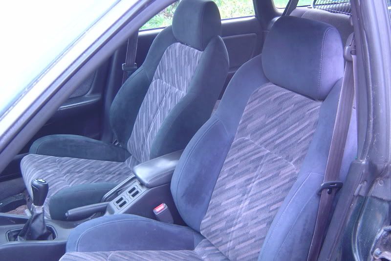

JDM GT-B front seats for some extra support...

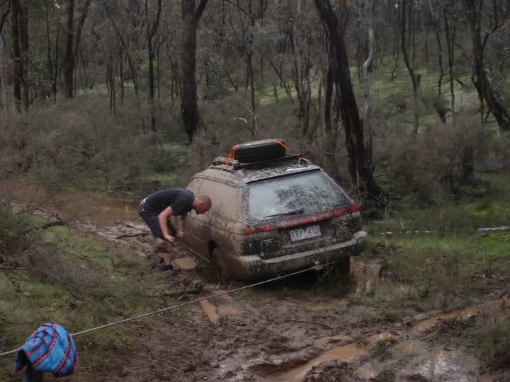

Bogged in Heathcote Greytown NP in Victoria, Australia. We thought this was a track but it was actually a dry creek bed that ended up not so dry...

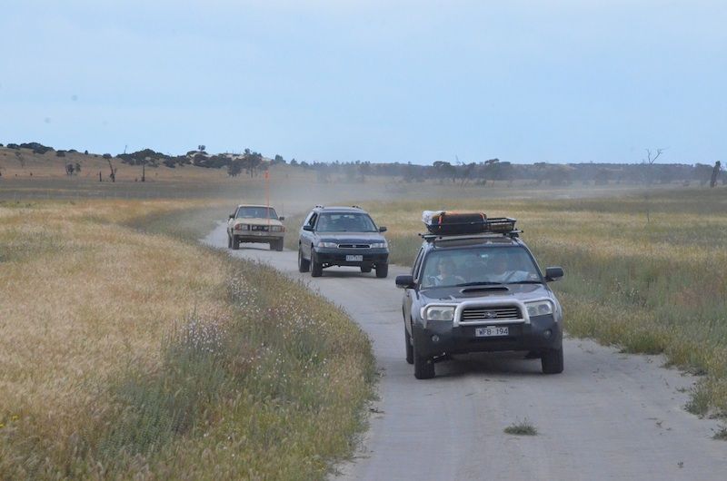

My first trip to Wyperfeld National Part, Victoria. With the guys from Ausubaru.com and offroadsubarus.com

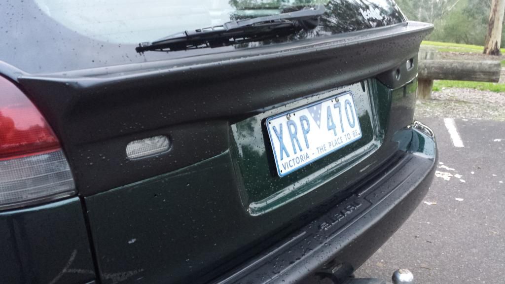

JDmmmmmm mid wing.

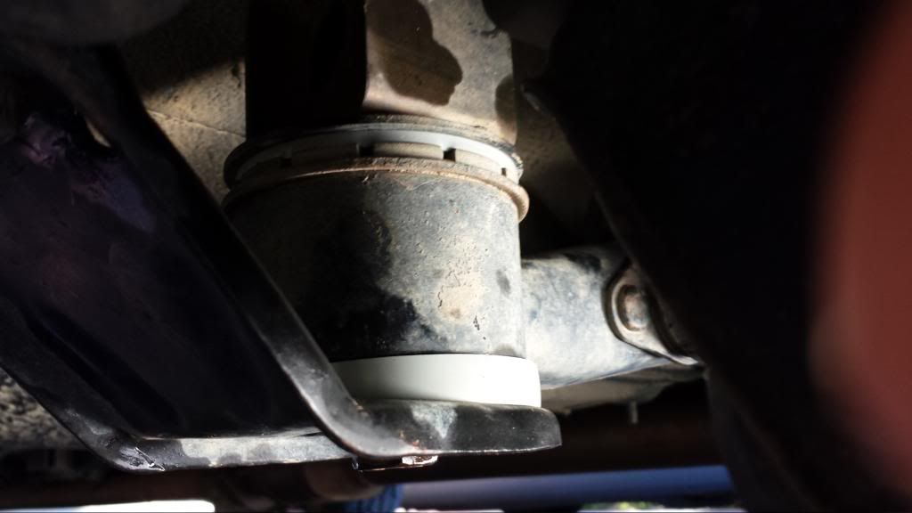

Kartboy mustache bar bushing kit.

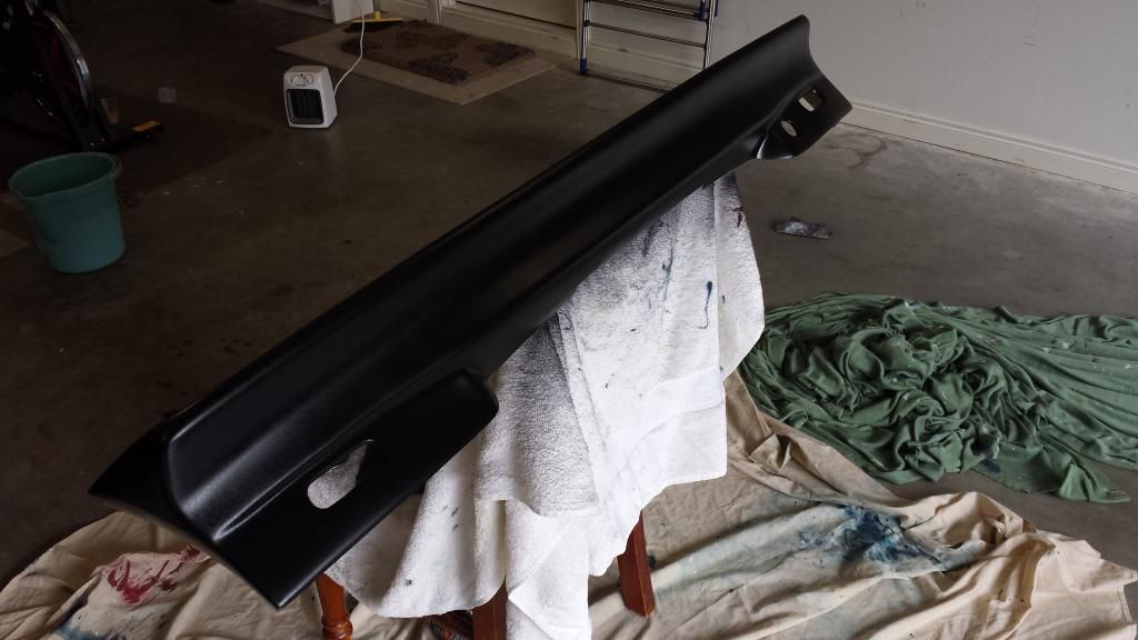

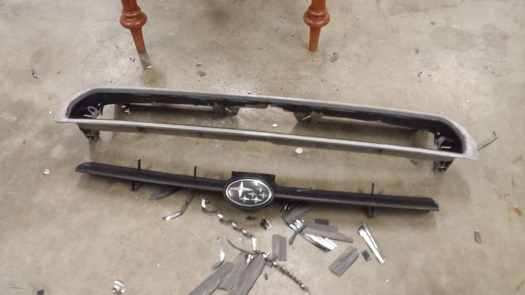

Cut up a stock grill as a little project. The chrome was peeling off this one so it was toasted anyway.
After some matte paint.
Mid-wing fitted up and the tailgate debadged.

Is that Kevin leading the pack in the silver Forester?
