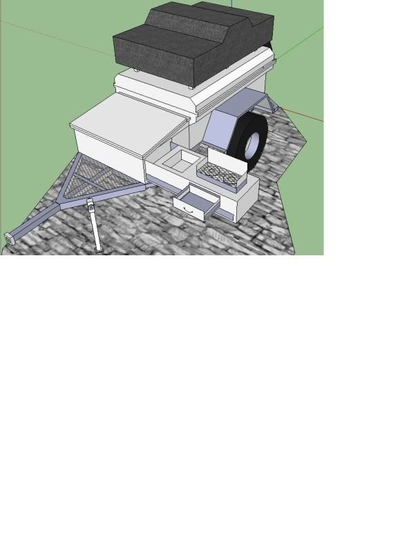

Ok here are some pix of a rough plan I am going to be building and one of some of the sheet metal I got for free its 12g and im going to use it for the main tub and for the fenders and ill be using some lighter steel for the other box and lids ill post up my material list soon im still debiting on what to use for some parts but I am going to be basing it off of a m416 look and I will have independent air ride suspension and 33x12.5x15 tires and most likely a AT coupler and an camping lab RTT some other goodies but I most likely will not really get started till after I get back from vacation in the first week in August I just have to much going on before then so anyway here are some pix

Well damn son slap yourself on the back!! Hell of a job!:victory:
I like it, especially the pull out kitchen. Great job on GSU...I love it

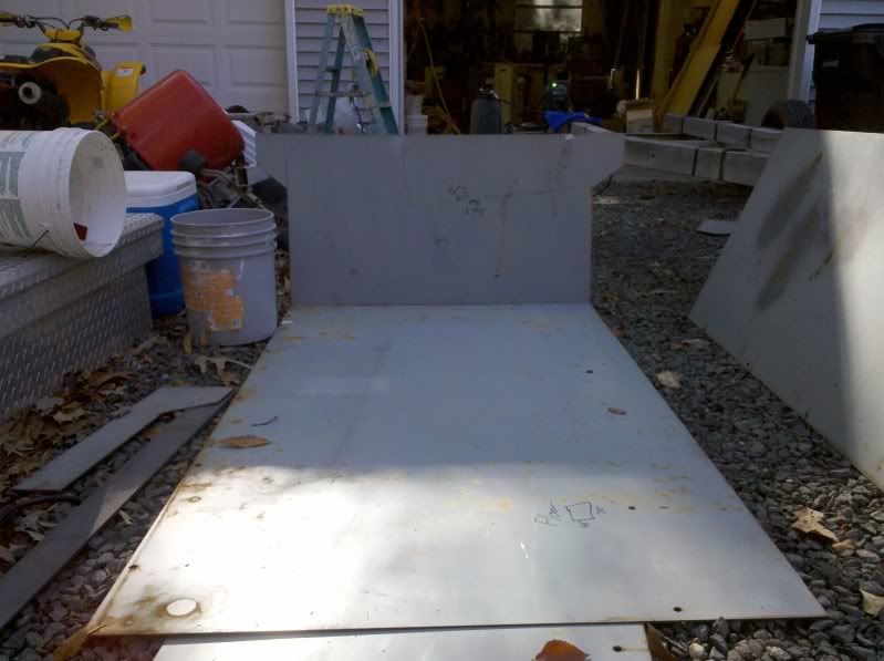

Ok I know it's not much but I got to use my new plasma cutter on the 12g sheets to cut out the tub now I just need to take the 2 sides up to the metal shop up the street so they can bend them for me here is a pic of the floor and one end propped up and one side is leaning on the old boat trailer I'm taking the #s and title from for this trailer and I'll be using some of the box tube fro me it to cut costs

merlin44
Thanks for posting your build. Did you take your body tub dimension from an existing trailer? Also, wondering if when you have the sides bent, do you have tabs bent at the ends for welding? Or will you just butt the corners together and weld. I only ask because I am starting the same way you are, with new sheets. Thanks for the input, hope it goes well.

I had researched and found the original dimensions and when doing so I found this file on here that had all the dimensions and bends already figured out to what I guess is right so I was going to build it to those measurements but the free metal I got I could get the floor and one side out of one piece but would have a 5" scrap so I decided to make my sides 5" taller so now my tub is 23" deep instead of 18" deep but here is the link to the file I don't remember who made it but it's nice http://www.expeditionportal.com/forum/attachment.php?attachmentid=55294&d=1301501887
Also there is no tabs I'm huts going to be butt welding the tub together the 12g is plenty stiff and thick enough to get a nice weld on
And good luck on yours
