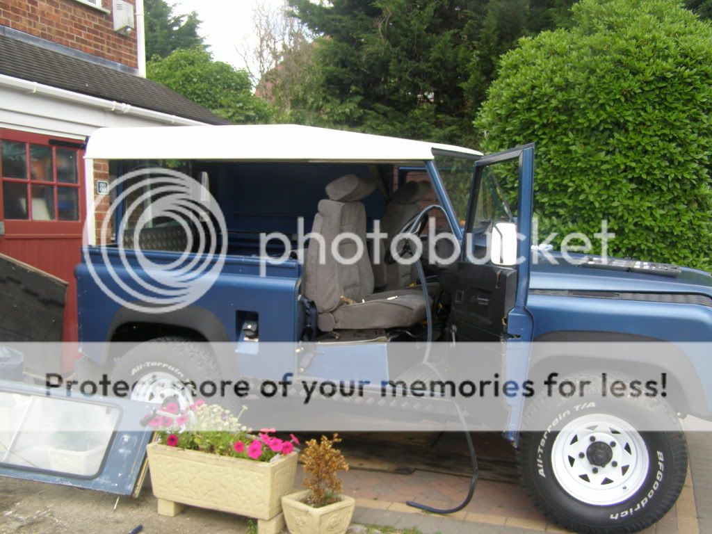

Thought Id start a Thread up on here of the Rolling restoration/preparation of my truck, Hoping to hit Europe next summer, then is Funds allow morrocco the following year. After morrocco who know, id really like to hit Africa but we shall see, I may need to upgrade to a slightly larger vehicle but we shall see :sombrero:
So here's how I bought it
Fisrt thing to do was fit Windows in the back, far to dark in there! Also because of the London low emission Zone I had to convert it to an estate to be compliant
All Done
Know to modifications, Everything as you will see was done on a budget, as Im a poor student, once cash comes in things will be replaced with better quality items
