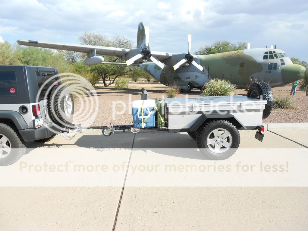

So i wanted a WWII Jeep trailer (M-416) and all i could find was rusty piles of crap for $1000 +. So, 2 years later im still not finished but its good enough to show.
I built the whole thing from the ground up. After going to a junk yard to get measurements and finding parts of original dimensions online i went to work. i didnt know how to weld when i started but by the time i finished the structure i had it down. I used 1/8 in steel sheet for the tub and fenders and 2x3 in tube for the frame. I built this to be a Adventure/camping, Bug out trailer, so when it is not in use for family
camping, it is loaded and ready to go. Once i got it built, before final sand and paint i took it on a 4X4 camping trip to see how it held up, well i gave it hell and im pretty sure this will outlast the jeep, its a Tank!
NOTE: I used spray paint for a reason, if i damage it, it wont be hard to do a repair and match the paint. And its cost effective.

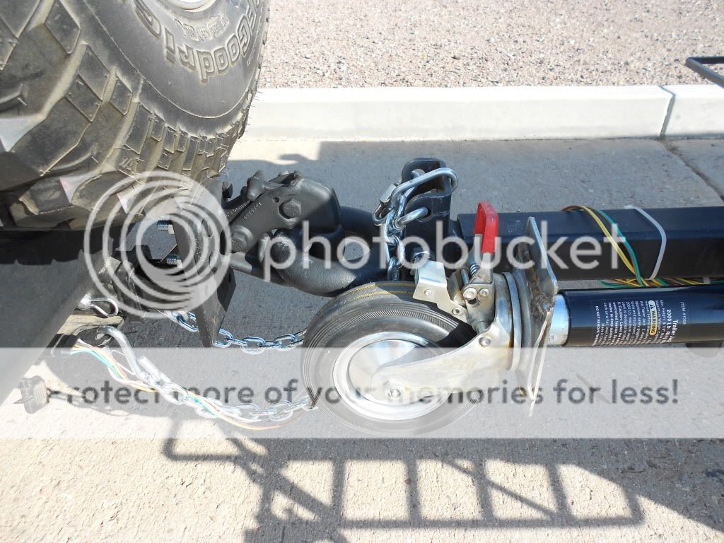

Mil Pintle hook and lunette
The tongue is extendable if i ever want to get a canoe to throw on top

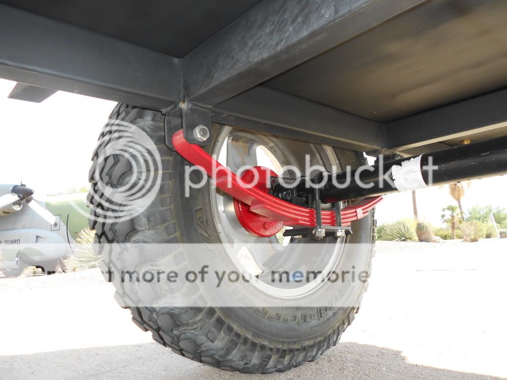

3500 lb axle and springs

Wow! great job on the trailer!! I like the fact that the lid can be used as a table, very cool!
Love the 'accessories' in the last pic! You're going to need another trailer just for the toys!

Where did you source the axle, what brand and did you use spacers?
If so what source/part #?

Definitely had to use spacers, the Moab wheels won't work on regular trailer hubs without reaming up the center hole on the wheel or spacers. I went with 2" spacers and the cheapest I found was on eBay for around 60$, i just looked till i found the correct pattern. Now that I have the spacers on there all my wheels are interchangeable. As far as the axil, we have a place in town called wheel equipment and they are a trailer parts warehouse. I went to them and asked for a 3500lb axil and gave them the length I needed and the gave me the axil, I know not much help but it only cost 80$. Maby they shipp, or just look around for a 3500lb in the length you need. They measure from hub face to hub face I think.
