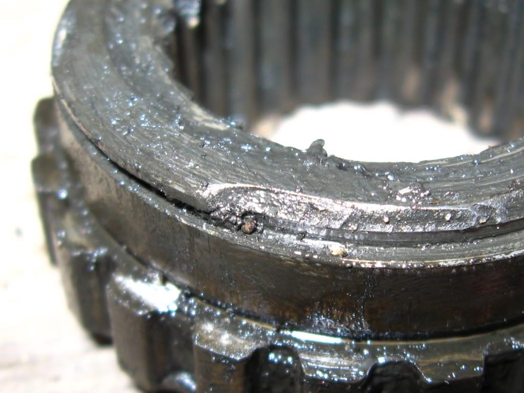

While in the process of pulling my passenger side cv axle out, I noticed something not good....
....my hub came off in 4 pieces!!!
The hub is an Aissin, stock, off of a 1998 Tacoma. The parts that I need are the center cog (not sure what its really called)...
and the c-washer on the far right of the first picture. The c-washer isnt a real big deal, I can always beat it back down flat, but that center cog thingy looks like its toast. I'm a little surprised that it even still works at all.
If you look closely, you can see where the retaining ring has chipped off and in the 3rd picture, you can see all thats left of it. About 3/4" or so.
Anyone know where I could get just those parts?? I don't have the money to buy a new hub right now. If I can just get that cog, the rest of the hub is fine. Thanks.

Those hubs are like hen's teeth, but used ones do pop up for sale fairly often on Tacoma Territory or Yota Tech. You were a week late for the score: LINK
You may want to post up a WTB thread on those sites, PM anyone doing a a SAS and call some local junkyards.
Unfortunately, you can only buy the entire hub body instead of individual parts from the dealer, and they are expensive.

Thats the problem though. I dont have the money to buy a whole hub. Im hoping I can locat the inner hub (found out that thats the name of the little cog thingy) for somewhere down in the range of "cheap".
