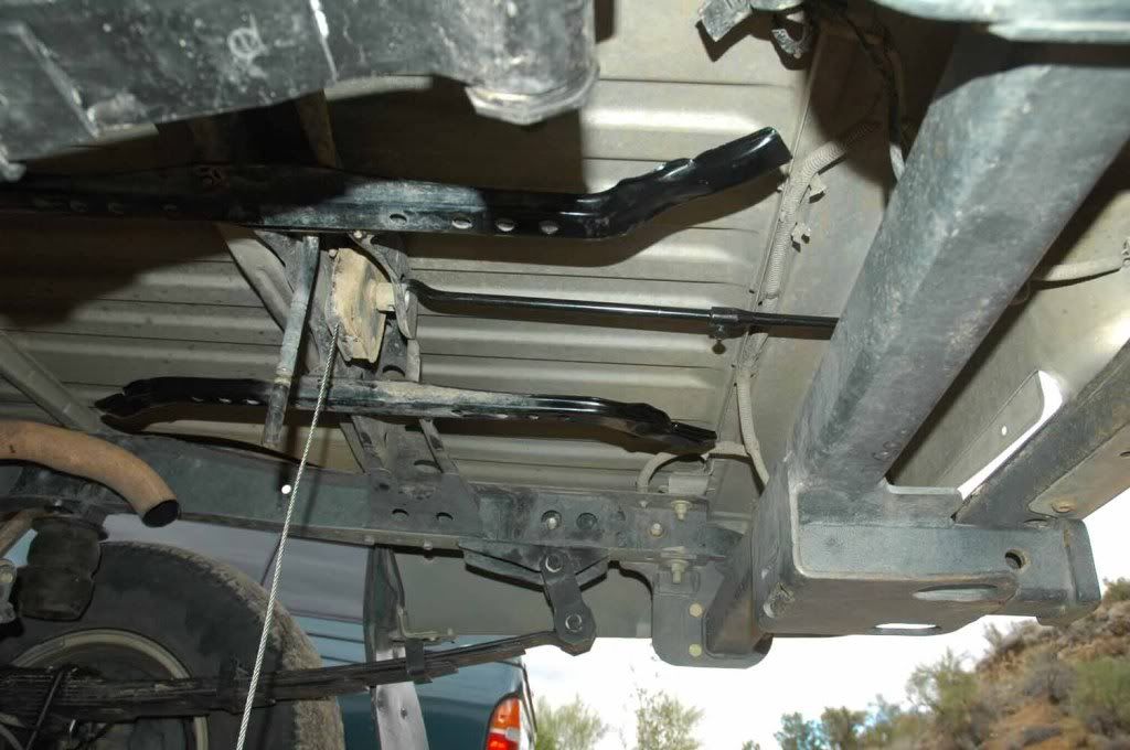

I finally got my 235/85r16 tires. I went with Yoko Geolander ATs to replace my BFG 31x10.5r15.
The tires are heavier 75 pounds, vs 65 for the BFGs, the ride seems rougher like the sidewalls are stiffer (but I don't know) I did get a rainy day to play in and the tires never broke traction, and I was pushing it through turns, etc.
The tires raised the truck almost a full inch at the bumper and wheel wells.
Questions, I did not get a spare yet, wanted to make sure it would fit under the truck....Is this too close?
And they don't fit inside the downward shaped arms... just bend back?
Thanks...

Odds are your tires are E-rated as the 235/85 is a common full-size dually truck tire. This would explain the stiffness and extra weight. My 235/85's + alloy rim = 82 lbs. :( suucks.

Yep, they are E... not much out there in D that I could see in person.
Thanks...
How much air pressure are you running? My load range D's feel like rocks above 45psi....you might try playing around with different pressures until you get a good ride with good wear. My Tundra is running 38 in the front and 30 in the rear (unloaded)

I had Geolander AT-S tires in the exact same size on my '04 Tacoma. I really liked them. Never tried to mount a spare, my thought was that a spare was just that - a spare, designed to get me home or to a place where I could repair it and I figured the minor difference in size between a 235/85 and the factory 265/70 wouldn't be enough to cause any severe problems (not like my AWD Subaru where I was promised dire consequences if I ran different tire sizes, so dire that they actually advise you to pull a fuse to disable the AWD system when you have a spare on.)
When my current BFG KO's wear out I'll most likely go back to the Geolanders in the 235/85/16 size, as that seems to be a good size for the kind of traveling I do.

I was curious about just leaving the 265 as the spare.... the other reason I liked teh 235s were everybody seemed to have the size in stock, so I don't think it will be hard to find a replacement if needed, but I am planning a 2 week trip to Nova Scotia, and was more concerned about that trip and having a spare.... thoughts?
