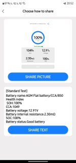

I have bought an odyssey ODX-AGM34R and my alternator voltage is 14.3 on a cold start and then rest to 14.0 to 14.1
Now I read in this site and many other ones that the battery needs 14.4 to 14.8 to fully be charged on a charger and 14.2 to 14.5 v from alternator. Mine is just at the lower edge , so do I need a home charger to compensate the phases absence from the alternator.
Where I live it's very difficult to find those fancy batteries, I.e. odyssey's and optima's , even though I have the ability to buy them, so I don't want to risk this one (produced Dec 2022).
Upon checking with battery assessment equipment I have it shows good condition and both SOH and SOC at 100%.
I have read many threads here talking about charging and stock alternators, but want to have a peace of mind so I don't need to start searching again for another battery on the hope this one will serve me for 3 to 5 years.

I’d like to suggest not worrying about it too much. AGMs, and Odysseys in particular, are pretty robust and forgiving. There’s lots of handwringing about charging them out there that’s overblown. Yes they like a good high voltage charge from time to time, but it’s not that big of deal. Buy either Odyssey's 25 amp charger or Victron's 15 amp IP 65 Blue smart charger (maybe better as it’s customizeable for LiFePo batteries and others, but has a dedicated 14.7 v option that’s great for AGMs).
I’ve had 6 AGMs over the past 15 years in 3 different vehicles. One Diehard (when they were made by Northstar, which is owned by Odyssey and equally good), one Odyssey, one Optima, and 3 Northstars. Only the Odyssey and the Optima were dual/house batteries, the others were all starting batteries, though all were charged in Toyotas with too low voltage. Only the Optima crapped out, and that was after 6 years, including at least a year where it was boosting a weak starter battery (not an AGM) through a dual battery system. Never had a problem with any others. Never failed to have plenty of juice.
I finally talked to Odyssey about correctly charging when I replaced the Optima with the Odyssey as a house battery in a dual, underhood system with an isolator. Basically, they recommended occaisional charging to the correct voltage. BUT, despite several years of not doing so initially with an AGM starter, never had a problem.
We’ve been running a Northstar AGM in my wifes 4runner which is a grocery getter since 2018 with no problems. Get’s driven maybe 2 to 3 times a week for short distances and NEVER gets well charged by the alternator. I’ve charged to the 14.7v maybe twice. I do periodically (maybe every couple months) put it on a trickle charger (Battery Minder brand, recommended by Odyssey) for a few days. The worst it sits at is 12.6v. Never failed to work. Will last another 4 years easy is my guess.
My Tundra with camper sits for weeks (in Phoenix heat), so about every 6 weeks I give it a charge with the Victron charger I mentioned above. And I don’t do that until it hits about 12.0v (it has several parasitic draws from a battery monitor and alarm). Going strong for 3 years now. Always gets well charged on long trips (eg up to 12.8 or 12.9v).
You can make yourself crazy reading all the stuff about boosting your alternator voltage and in many cases, as I researched this, people who do the diodes have created other electrical problems. Just buy a good charger and a few times a year give it refresh charge.
Maybe there’s something different with your system/diesel and someone with experience with it will chime in, but otherwise I think you’re gonna be fine.

Thanks man you made my day ❤️
I will take your personal experience as guidance in my first usage of an AGM. I will try to order one of the chargers you've suggested in the very near future

Thank you Howard for your helpful input. I was worried to undercharge my odyssey with my 14.0 -14.2 v but it seems they are very tolerant and friendly products. Since those are very difficult to find in Saudi Arabia and if found will be over priced compared to prices in the US.
I'm installing a direct line to the battery with one of those cheap gauges on cigarettes lighter inside the car to keep an eye on charging until I get something better from aliexpress with 4 digit display.
