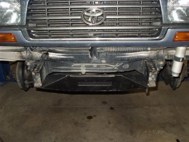

There is something about a winch that makes it seem like gold. I cant seem to part with them either. Have you thought about a hidden winch mount behind the front bumper? Then you would keep the factory lines of your vehicle, save a ton of weight, and you wouldn't need to swap suspension. Then down the road when you have the cash, you could swap the suspension and add a steel bumper at the same time.
My old FJ62 had a hidden winch mount and I will probably do the same in the future.
Welcome to the forum, by the way!
Edit: Here is an example of what it could look like behind the bumper.
I can understand hating to get rid of the winch, but I think you have a good idea in selling it and using the cash for tires and other recovery gear. Honestly, the rugged trails are awful and if you keep them you will need the winch. Another thing to consider is are you going to be taking your brand new truck down trails where you will be winching often, and if so are you going to be alone? I understand a winch can be an invaluable tool but for most of the trails and situations you will be getting into with a stock truck on those awful tires there will be other options for recovery. If you do decide you can't part with it you could look into having a receiver fabbed up to hide behind the front bumper and get a removable winch tray to mount the winch to. This gives you the option to move it from front to back and you dont have to haul around the extra weight when its not needed although you will probably lose approach angle.

Trying to remember if I ended up posting pictures of my rear receiver mounted winch. If i find it ill attach them. Basically welded a 12x12 plate to the top of the receiver with tube bracers to keep it strong. I cut a hole behind my license plate and mounted the fairlead on backwards on the back of the bumper. It is completely hidden, and has worked for near every stuck i have gotten into. I thought about putting it up front and for self extrication it is better for me to have it in the back to pull me out of something rather than pull me through it. Just my 2 cents

Agreed, then the weight is not an issue unless needed, and you are still able to have the recovery when needed in front or rear.
Yup..the best part is you can take it off keep it in your garage.
