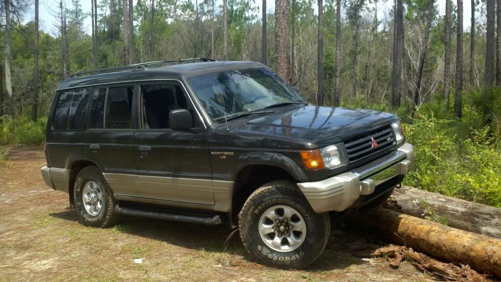

Well ... luckily for me my tire issue was solved. When my Heep (read: Jeep) decided to commit vehicular suicide, or Hari Kari in "Mitsubitchin" terms, I cannabalized my BRAND NEW (read: less than 2 weeks old) Firestone Destination A/T's in 31x10.50x15 tires off of it and mounted them to the stock rims.

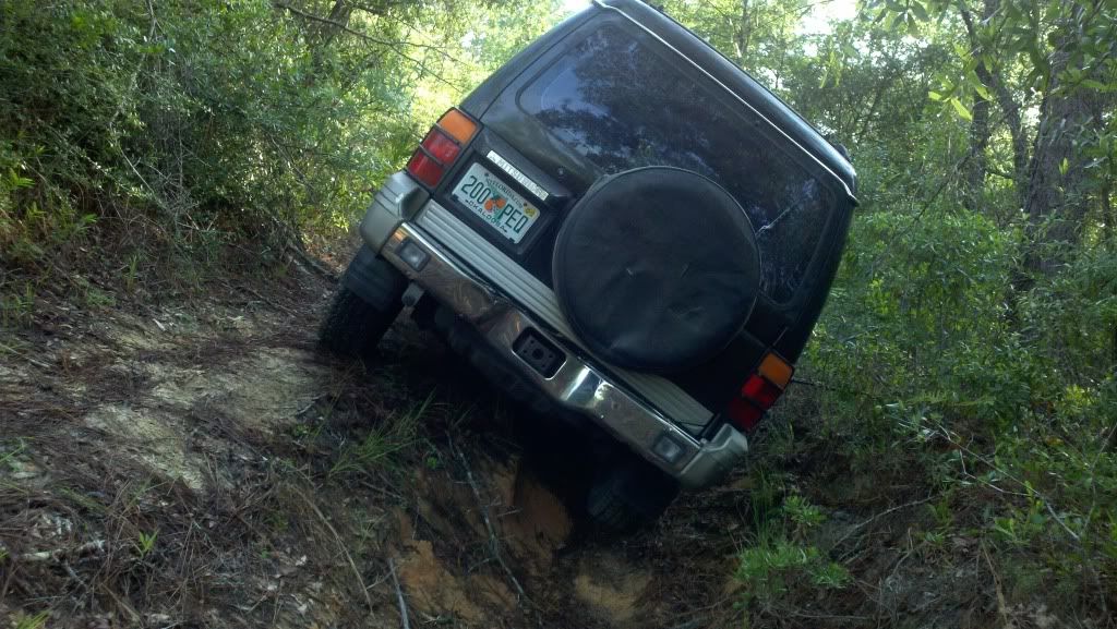

Those tires are perfect. They fit well (duh!) and ride amazingly. No road noise, and the grip is comparable to mud terrains. I took it out today to put it through it's paces (so I thought) and still haven't found this particular truck's limits.
Unfortunately I have to keep it a little lower than what I wanted because it's doubling as my daily driver/family touring truck. My wife would've let me lift it 2" and throw 35's on it, but she's so short it's a little difficult for her to get the kids in and out of their carseats. Cool with me.
Expect to see a build thread from me shortly in the future. I think the only things I'm going to do to it for now are a snorkel, bumper/winch, rack deal. Also, looking to see if I can garner enough interest to make a trip for all of us in the Southeast US states. I'm in Northwest Florida mainly, but willing to travel to other locales.
