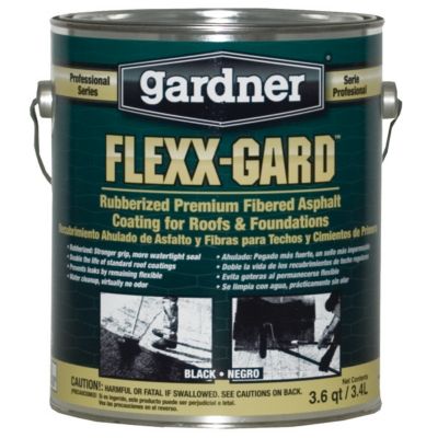

Trying to figure out what to use to seal the bottom of my teardrop with. I had toyed with the idea of when the body is fully enclosed using fiberglass and resin to seal the whole thing...any ideas would greatly appriciated:)

Great Start, Here is what I used on my bottom. Only $12.99 at Tractor supply.
Here is the link to my build.
Good Luck
Chris
Gardner Flexx-Gard Rubberized Premium Fibered Asphalt Roof & Foundation Coating, 1 gal.
