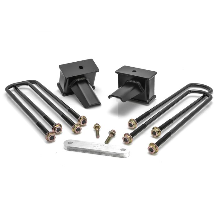

This may not be it exactly, but something a lot like this:
Ford Super Duty Rear Block Kit
I think that this needs some clarification.
Putting 350 blocks on a 250 will provide a lift and probably even things out visually. It will not make the 250’s suspension the same as the 350. The 350 has overload springs and that is what provides the primary payload capacity increase. Lift blocks provide a simple way to lift that is very effective (which is why Ford uses them) but the overall quality of the lift is not that good. Also, no suspension will really allow the truck to handle like stock with a camper attached - it will weight more and there is no way to eliminate that reality. A well-designed suspension will minimize the impact (and maybe even improve performance in specific terrain) but it will definitely not ride like stock.
Also, no one answered your question in your original post but yes, the factory suspension uses a two piece block. The upper portion is what you’d replace if you did a spacer lift and the lower portion (flat on top, curved on the axle side) is fixed.
Putting 350 blocks on a 250 will provide a lift and probably even things out visually. It will not make the 250’s suspension the same as the 350. The 350 has overload springs and that is what provides the primary payload capacity increase...
In my case it did make them the same.
The overload spring is included on the F250 in some of the configurations or packages. I purchased an F250 with the camper package. It is exactly the same springs as an F350, including the overload spring, but it had the smaller block. That was the only difference. I added the taller block, so it was the same as the F350.
The SRW rear springs are the same between an F250 and F350, it just depends on whether the F250 includes the aux spring, and that's based on the options.
