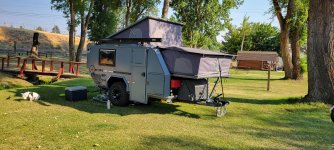

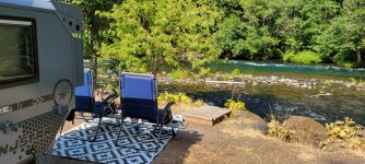

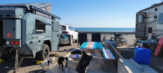

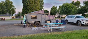

I wanted to start a thread for owners like myself to post pics and helpful information about our trailers.
We love our rig and we have really enjoyed our trips so far. We have a big mutlti state trip planned for July through the pacific northwest so we are excited to get some long stretches in the camper.
I am hoping more buyers find this thread and join in with their experiences 😀
