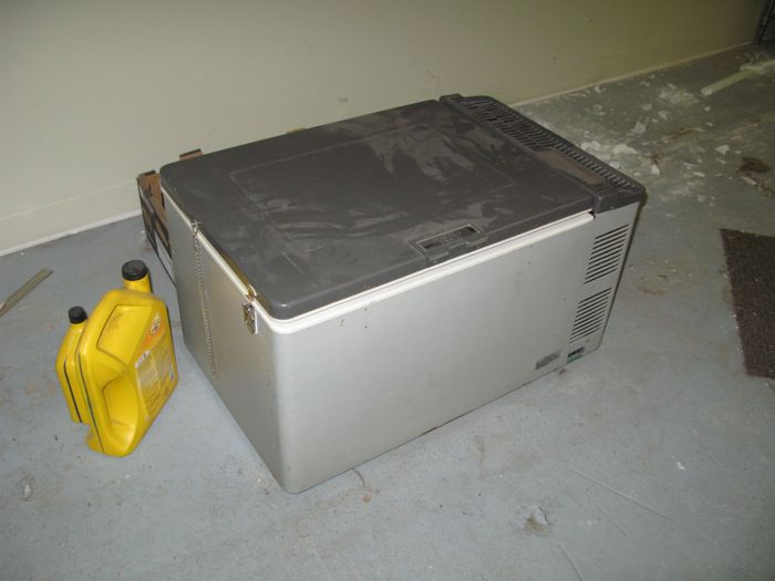

before you get too excited it dosnt work, I have no idea what the problem is and have taken some cover off to look things over quickly but to be honest I dont know anything about them. I figure its good for parts at the very least. baskets are still in it and over all no too bad shape. No shipping Its located in bellingham wa but I might be willing to hual it down to seattle since Im moveing there.

If it doesn't work on 12v or 110v and doesn't smell like ammonia, odds are the board has gone out. Around $400 to replace. I have gotten several of the norcolds over the years that had died because someone had them hooked to a battery that they then hooked a battery charger to and it fried the board. Funny thing is that the boards on most fo the smaller norcold units will fit it so if someone were looking to move up in size..
