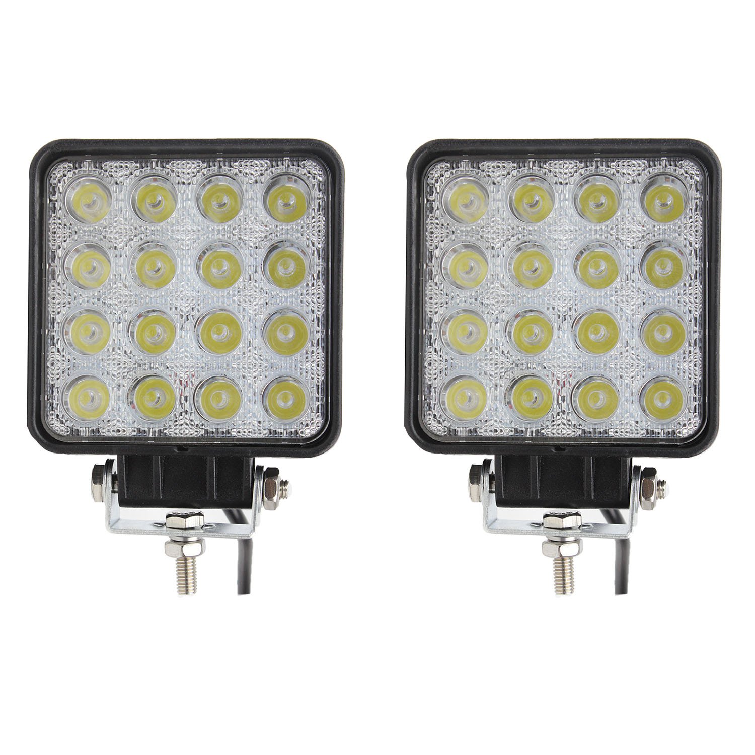

I just ordered my son these spots for Christmas ($20.00) and am thinking about a pair for myself. I already have some old school KCs that are more of a flood than a spot and they can take a beating. I am not sure how durable these spot will be. They get good reviews.
https://www.amazon.com/gp/product/B01EAN9DUU/ref=oh_aui_detailpage_o01_s01?ie=UTF8&psc=1
I think I actually have those lights on my "wish list" on Amazon, to replace the PIAA halogen lights on my BMW. The PIAA's are nice and bright, but they're hella expensive (new bulbs are $40) and they only seem to last a few months before they go out. I'm going to replace the PIAAs with LEDs.
