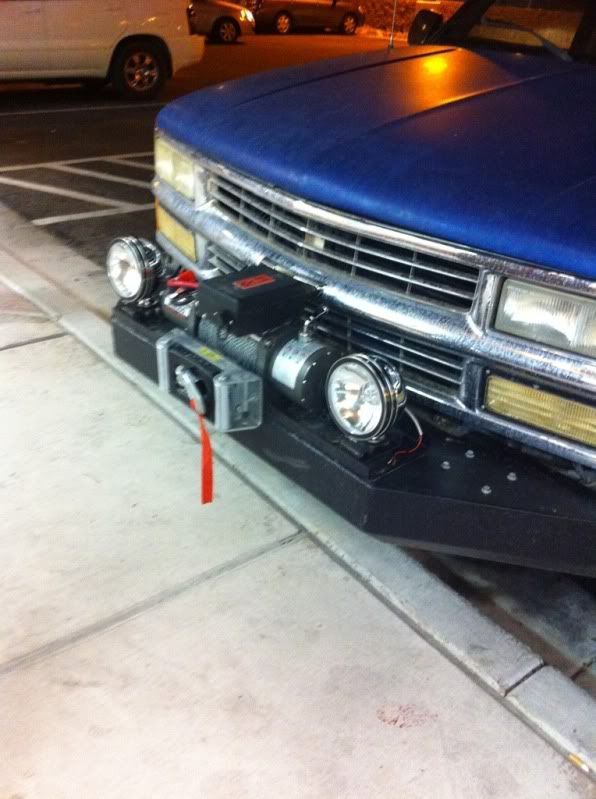

The lights are on and hooked up and i love them, they were pricey at almost 200 a light but are well worth it and so much brighter than the cheap halogens were. Heres a few pics
The lights Rigid industries Dually D2s
compared to the halogen
on the truck their small but i like them

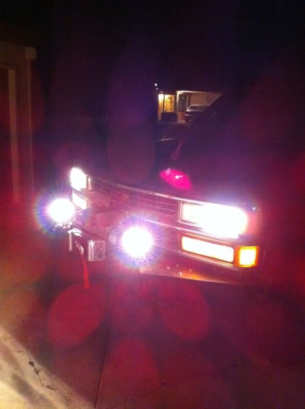

My hi beams on
the Duallys on
bobDog
I have always hated small cheaplooking lights but those look quality and seem to be really decently bright + LED. Yeah nice.:smiley_drive:
Not cheap at 200 frogskins tho!
