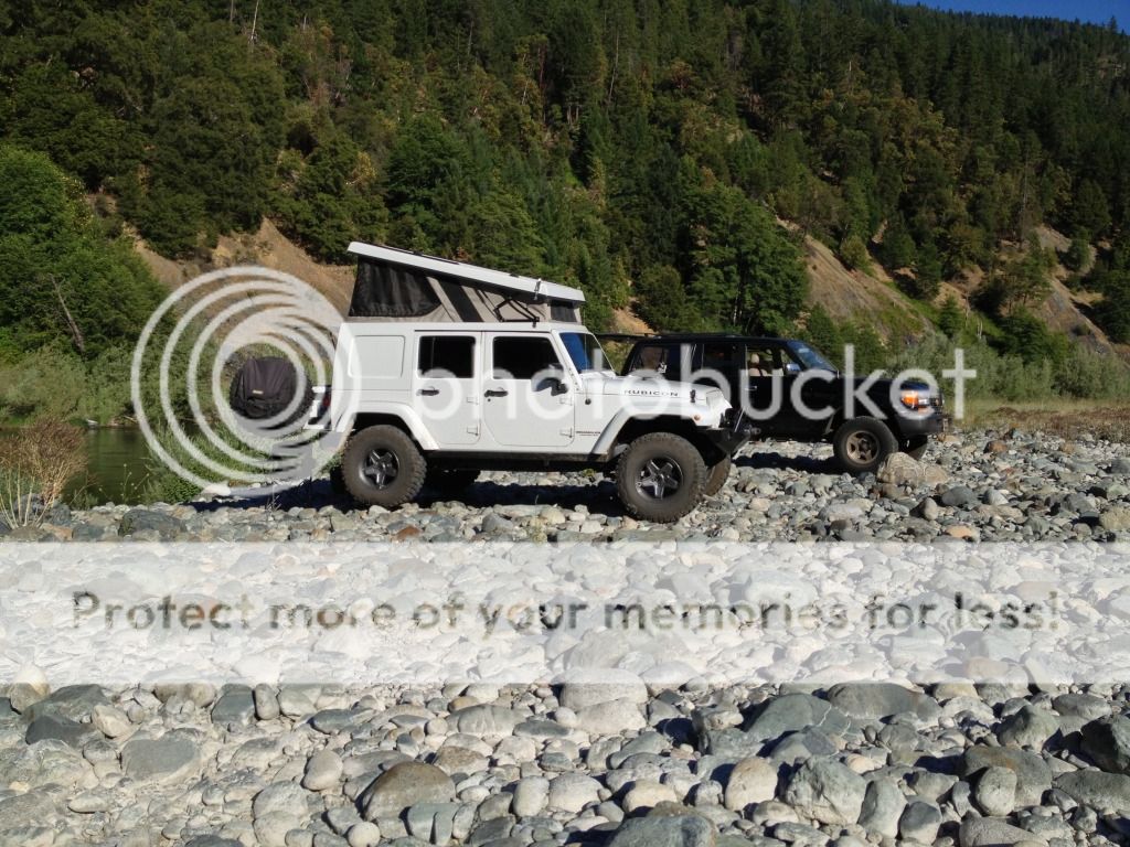

I have the AEV 3.5" but can recommend the 2.5". The only difference (other than spring height and shock length) is that the 3.5" came with a flipped drag link and front axle side track bar bracket. Oh, and the control arm brackets. Functionally it's pretty much the same, including the rear track bar and tower.
The spring/shock combo is amazing for the JK. I've put many long days on miles on my 3.5" on 35s very smoothly and comfortably, and it works very well off road too. It articulates just fine, and handles higher speed washboard/unimproved forest service type roads amazingly well, particularly of you air down a little.
However you will want an adjustable front track bar to center the axle (and for the huge steering/handling improvement anyway), and either the control arm brackets or adjustable front control arms. Same goes for either lift though.
My JK weighs in at roughly 5500lbs with me, a full tank of gas, tools, compressor, camper top etc. Handling is great even with my wife and a bunch of additional gear. I have a 100lb front bumper and 80lb winch and the front barely dropped at all. Actually I wish it came down more!
Here is mine, packing around a bunch of weight.
It works just as well off road as on. Though I have upgraded all steering related components up front as the stock parts are terrible for hard use.
