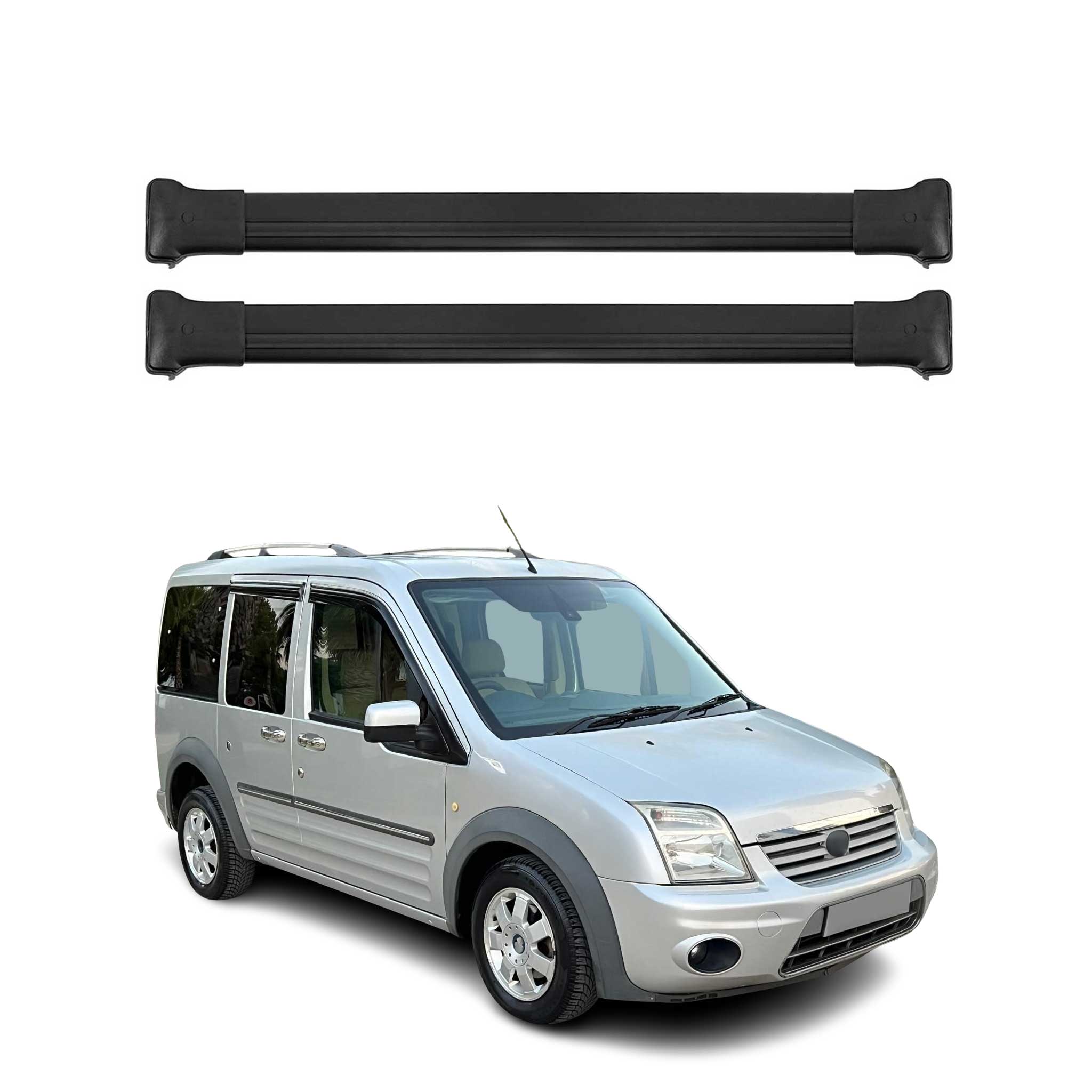

Sorry for not posting in a while. Some things that I have done in the past few months are- Get a roof rack with low profile cross bars, boos bash plates from Australia, mount my new rims on 265/75/r16 bfg KO2's, fix my air leak on my lower plenum, timing belt/water pump job, and fix my transfercase issues.

Truck looks great. Do you have a link for the roof bars that you installed?

I sure do.
Here is their ebay link
