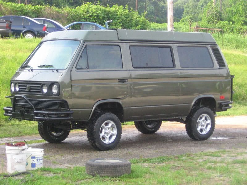

To the OP. I cannot say why, but your rendition of the VW with the black wheels didn't work for me. To each their own of course. I guess it made the wheel/tires all look really small. Perhaps dark green to match the rest of the van.
