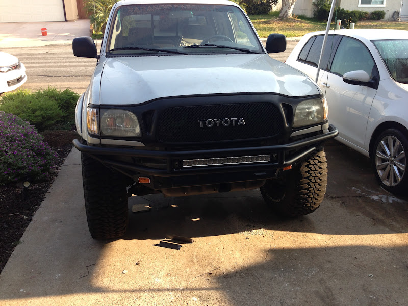

fist mod was kinda cheesy but i liked the look as it reminds me of my fj40.
bought a new grill and grillcraft grill and a toyota badge and installed it.
also installed some hella horns to fix the anemic stock toyota horns lol.

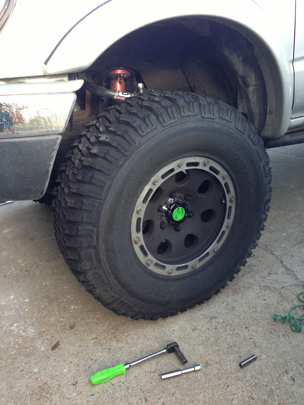

well finally got the locking hub setup installed.
guess i didnt research enough i guess and didnt know about the abs issue lol.
i just swapped full knuckles so i lost the abs port. i will probably fix that soon, currently i just put a cap over the sensor and zip tied it to the spindle and took out the abs fuses.
also, got it all bolted up and finished spun the wheel and come to find out one of the damn boots has a hole in it and was oozing grease lol. doh.
