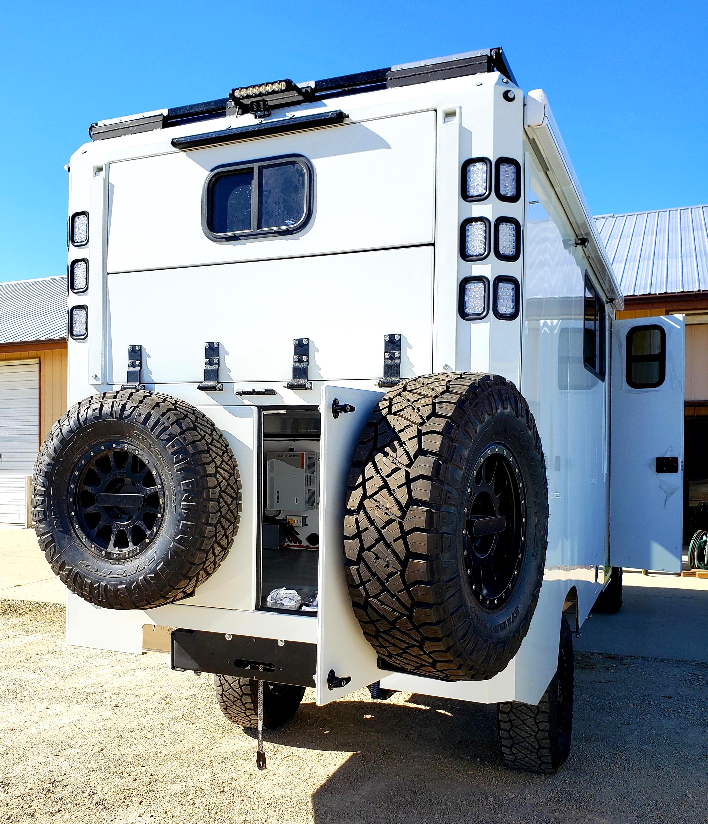

TIRES MOUNTED IN THE REAR DOORS. LAST PICTURE.
  • The very last picture shows how the tires would look mounted on the rear doors of the Ford E-450 camper.
  • This picture is of my custom Isuzu NPR crew cab Camper. I am also selling this. This picture shows 37" Nitto Ridge Grapplers. I took this picture 2 months ago.
  • I will list the NPR Crew Cab camper in the next 3 weeks, as it is just being finished, and the rear bumper with 16.5 WARN winch was just installed.
  • I just wanted to attach this picture so you could grasp how the tires would look mounted on the rear doors.
  • The rear hammock chair arms (seen on the rear of the camper, to the right and left side of the porch flip down doors) are also used to lower the tires off the door onto the ground.
  • You can also see how the rear and side hammock bars lay flush against the outside camper wall on the Isuzu NPR camper. The Ford E-450 will operate and look the same.
