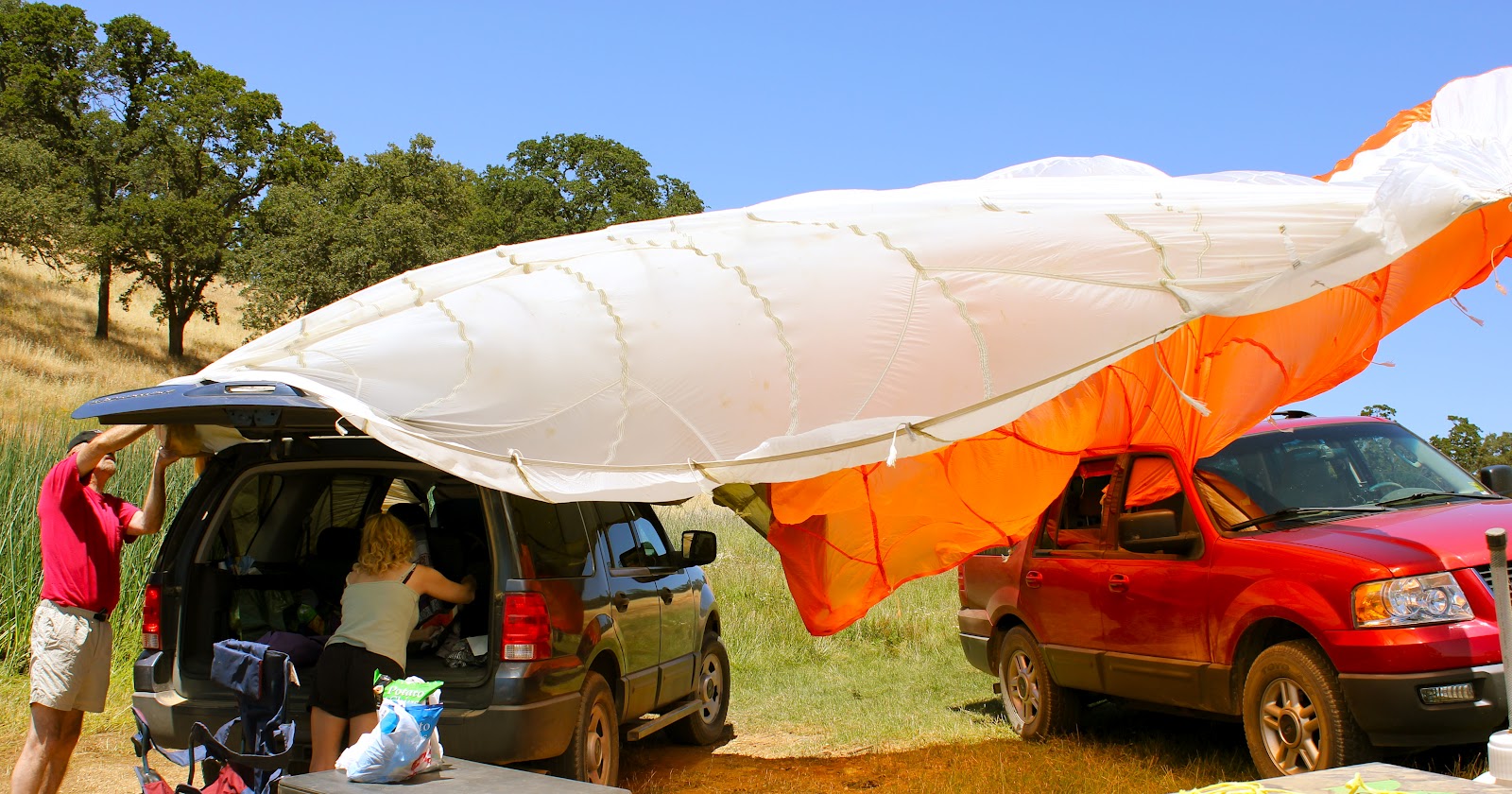

It would seem so, but nah. When I can, I like to park in the shade. When I can't (which happens quite a bit, as I love the desert), I have a parachute that I use to cover the truck. I stretch it out and tie it off to stakes, to make a nice shady awning all around the truck. Kinda like this, but with a truck in the middle instead of a center pole:
I used to do the "unpack all the crap and pile it around the truck" camping style. I decided it was too much like work, and I was camping because I was trying to avoid work. If I still did that sort of thing, I might consider a solar panel that I could put out in the sun and move around, but I'm trying to stick with the "pull up and park and kick back" style of camping. Yea, staking out the chute is a bit like work, but what the hell...shade rocks.

I like the idea of the surplus chute. Found this online
Do you just 550 cord it to various trees? is there a particular shape you go for each time?
