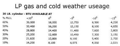

I don't have a proper gauge to measure, but I do have one of those cheap ones that displays "how full is the tank" but actually ends up measuring tank pressure.
With full 20lb tanks, it dropped in half just from the temperature change (40 when we left home, 12 the last time I checked it).
The heater ran all night, but I get concerned that if the tanks weren't completely full to start they'd have cut off in the middle of the night. We have a 20k BTU furnace.
Those numbers across the top of your chart... are those temperatures in F, C, or something different entirely?
The chart temp is Fahrenheit
