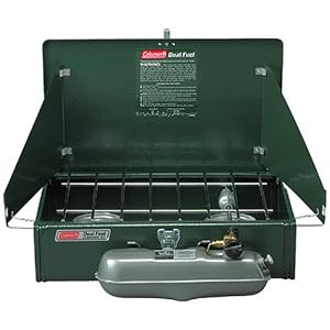

I have one of these, purchased new 2-3 years ago.
[ame="http://www.amazon.com/Coleman-Burner-Compact-Liquid-Stove/dp/B0009PUPX8"]Amazon.com: Coleman 2 Burner Dual Fuel Compact Liquid Fuel Stove: Sports & Outdoors[/ame]
Currently the tank is partially filled with white gas. Would it be okay to store it like this for months-long duration?
I've heard about the seals in the stoves generator deteriorating overtime and I don't want to contribute to it by storing it improperly.
Also - can anyone link a good source where it documents how to check and re-condition the generator? My biggest fear is having some sort of leak during operation and having the stove blowing up on me..
