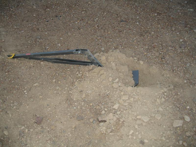

Miles
goodtimes said:
We played around with one last weekend at the 2007 Expedition Trophy. We were in moderately moist sand. It worked very well when hooked up to Eds FJ40. I imagine real dry sand would not work quite as well, and packed dirt/rocks would probably not be the best substrate either.
It did require 2 people to use (one to operate the winch, the other to set the pull-pal)....unless you have a long cord on your winch remote, or a decent range on your wireless remote.
Photo of Demo.
-Miles

dhackney
We have tested our 14k Pull Pal with our FG.
Tested vehicle weight was ~15k lbs.
Incline was ~5 degrees
Distance from front and back winch (we tested both) was full extension except for the last 6-7 wraps of the 16k Warn winches - ~ 80-90'
Soil was mixed dry sand & dirt with small rocks
We dug a pilot hole of ~18" and steadied the Pull Pall in the hole until the winch took up the slack.
We had no difficulty in pulling the truck all the way to the anchor. Keep in mind the truck was not stuck, although we did apply braking force to ensure a good wrap.
