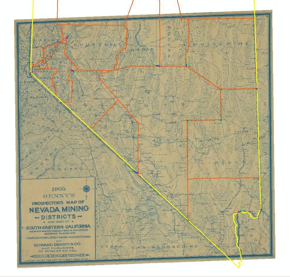

winkosmosis
I just downloaded the file. I really don't think datums have any relevance here-- it's just a map, not a high precision plat. For example you can tell by looking at it that the roads were hand drawn. You just need to georeference it with a some good points and find a polynomial warp that makes it match the current features. You'll never get it more precise than the scale and the original mapping precision allows.
I'd georeference it for you but I don't have any Nevada data. I'll see if I can find some tomorrow. Can Ozi read projection files or does the whole thing have to be resampled to a geotiff?
craig
Supporting Sponsor, Overland Certified OC0018
This sounds like what I am talking about in terms of a "map graphic" or fictional projection model. I'd think that the easiest way forward here is the rubber sheeting method as opposed to trying to actually determine the datums that may have been in the original source material used to create your map.
That's what I was suggesting too, with one caveat.
The datum will become a problem if the lat/lon lines on the original map are used because those lines are tied to a datum. If map features other than the lat/lon grid are located on the original map are identified on a second map where the datum is known, he can rubber sheet to the datum/projection of the known map.
Craig
DaveM
Craig
Yeah, I like your method. I was just separating out the registration operation into it's simplest form, no need for a referenced 2nd map. Simply find co-ordinates on the map with known points and use a GIS package to rubber sheet them into correct alignment with each other. In looking at his map (the scale, extent and precision) I don't see that much more would be gained by going beyond a simple rubber sheeting.
winkosmosis
How's this? I georeferenced with county and state boundaries. As you can see, the points don't really match up. I've georeferenced a lot of old maps and that's just the way it goes. I didn't do 2nd or 3rd degree polynomial transformations (what craig and DaveM call rubber sheeting I think) because there was too much distortion.
I can send you the JPG with the georeferencing file, assuming Ozi can use that data
