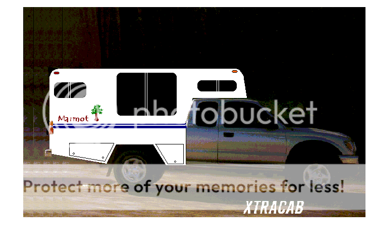

I've dreamt of building something similar--here's my result from Paint:
