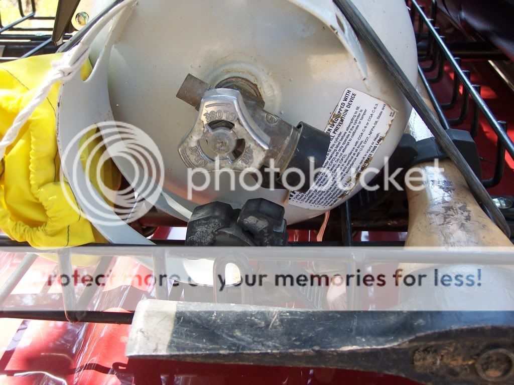

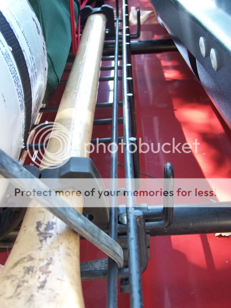

I have been thinking of doing the safety cable thing myself.
So far after hundreds of miles off pavement driving I have had no problems.
The rubber strap on the propane tank was just to hold the little yellow bag in place. It is not holding the propane tank.
