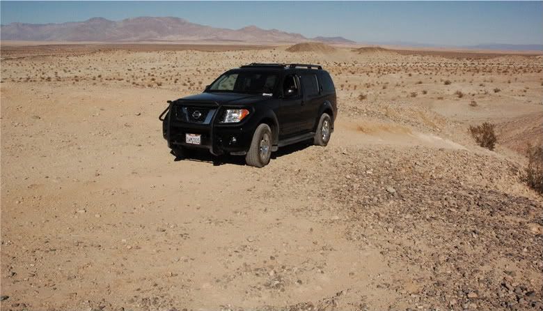

This is my 2nd R51, my 1st being an 06 XE 4x4 that I used to drive in Occotillo Wells, CA a bunch. No pictures of my new one, but here's one of my old one. :)
