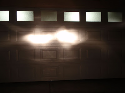

Pic of the Hella 700's on:

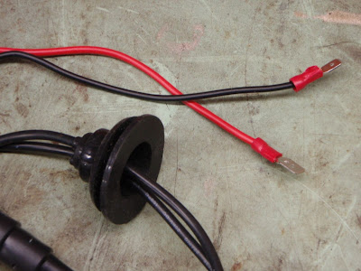

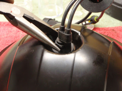

The kit has the red and black wires through the grommet to attach within the housing. I decided to pull it through and attach it outside the housing. I had to pull slowly and carefully in order to not damage the grommet.

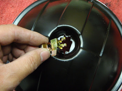

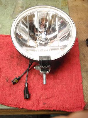

With the lens removed from the housing, I removed the metal clip that holds the original H3 bulb. Can't use as the HID H3 bulb has too wide of a base and the clip won't fit.
I placed the HID H3 bulb into the lens. There are two tabs that I bent to hold the bulb in place. Surprisingly, they held pretty well. At least hopefully until, I can figure out another way to keep it in place.

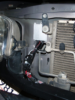

Now to mount the ballast using zip ties and connect the wires. Connected the red and black wires to the Hella ground and + wire. All the other connections are literally self explanatory and there's no need to explain that.
Pass. side, bundled with additional wiring for other aux. lighting and the Hella wiring. Driver side is pretty much identical as far as location.

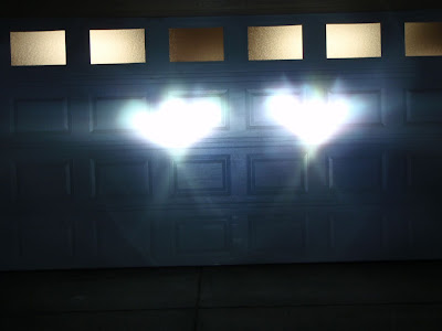

Here are some pics of the differences. Hella 700 55W vs the Raptor brand 35W HID kit:
Hella left, Raptor right:
