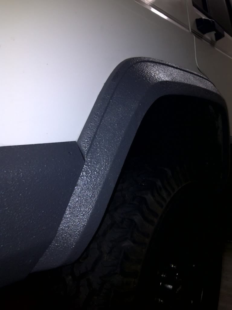

So the fender flares and the lower moldings on the Jeep were looking a little "Old" and I though I wanted to keep the White/Grey XJ Country look. I started looking for a do it yourself Line-X style product. I found Raptor Liner by U-Pol. It is tint-a-bule if you buy the correct style. I thought I could add the right color of grey and spay the original grey parts grey on my white jeep.
Prep was the hardest. I took off the moldings and flares. I had to take all the sticker backing off the metal. Some razor blades and time was all it took. I then skufed (SP) up the paint so the Raptor would stick. Then taped off the door jams and nice white paint. Mixed up the color and went for it. Here are some pics.
Original Jeep
Prep work
1st pass with the area well taped off
After 2 coats of Raptor
I am very happy about the results so far. Now I just need to reinstall the flares and go jeeping.

I really like the texture so far. Being able to add color sold it to me. I bought it at Amazon for around 100.00 The nice thing is that it comes with an air gun and 4 small containers equaling one gallon. I still have 2 left.
The feel is very hard, almost like line X it is not soft at all.

So above is Lewy's two coats of Raptor with a good representation of the texture, and below is my interior after two coats of Herculiner. Should be a good A/B comparison.
Just looking at it this way I am liking the Raptor liner better than the Herculiner but I guess I'm stuck with it now. The Herc seems to be more jagged and chunky whereas the Raptor is a lot more even.

On my Jeep the application of the Raptor was easy. The prep was a ***** but I guess it would be the same for both products. I did Herc at work for a screen cleaning room for water protection. It has lasted very well. It is softer, more like a rubber. This is hard, more like a plastic. It does not give at all.

Here is a side shot of the Jeep, Sorry I broke a bone in my foot and didn't want to pull the Jeep out of the Garage
Here is a fender flare shot
