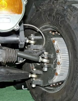

Raytheon has developed a concept vehicle for the military to show off their electric drive motors.
The HY-DRA concept vehicle seats 3, with the driver in the center. The vehicle is called a hybrid, but the version shown has electric power only, good for about 16 miles of silent running. The battery pack occupies the space below the seats.
Each 17 inch wheel has its own electric motor. The combined output of the four motors is more than 800 ft-lbs of torque!

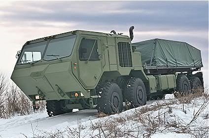

Oskkosh created a serial hybrid drive for its HEMTT heavy truck. A 400 HP Cummins diesel turns a 200 KW generator, which in turn drives electric motors at each wheel. Direct drive eliminates the torque converter, automatic transmission, transfer case and drive shafts. Oshkosh uses King Kong-size capacitors instead of batteries to store the power needed to start rolling.
Oshkosh says the switch to serial hybrid improves fuel economy 20%, no small matter when the standard diesel truck burns a gallon of fuel every 4 miles. Read more about the serial hybrid HEMTT here

Goodness but that concept car has some serious scrub radius issues. Hub motors have one huge detraction, they are heavy & drive the unsprung mass unacceptably high.

That Oshkosh system doesn't seem very efficient. If the IC does make 400HP then a perfect generator would yield 298KW. So that system is giving up 98KW (131HP) to conversion losses? That's 32.75% of the total power produced.
Is it possible that the 400HP rating is max power at WOT? If that is the case, the engine is probably more fuel efficient at 70% power or 200kW. Possibly. :eek:
I know the manufacturers tell us our vehicles have XXX horsepower at XXXX RPM. That is at Wide Open Throttle (WOT), and only at that narrow RPM range. Most of us don't do any sustained driving in that range. Most of us rarely get to that point when we get frisky with the skinny peddle. I'm always more interested in the max torque, and what RPM that shows up. Lower RPM the better.:safari-rig:
And I totally agree about the unsprung mass issue and wheel motors. Yuck.

It probably is the peak at WOT, but in that type of application (effectively stationary) it would be ideally run at it's peak torque rpm for best BSFC. Given the typical flat as Nebraska torque curve of a large diesel engine the power output should be pretty linear to engine speed. Which would need a wide power band to effect a 50% change in power vs. engine speed.
All of which means that someone picked relavent numbers that sounded good without understanding which were the important numbers and their relevance to each other was.

There is a lot that can be said about diesel engine power curves; but this link covers most of it pretty well. Considering the fuel consumption curve, relative to the max HP point, I woud say 50%-70% looks like a good range to make electricity, on a continuous basis. Although the engine could probably run at 95% all day long, it looks like they didn't design in any excess power, other than the capacitors.
If I am missing something, please let me know, as diesel power is still a bit foreign to me.

Are they really using those spindly little heim joints to suspend the motors? Surely Raytheon would have researched off road vehicles a bit to learn that heims don't work well off road.
