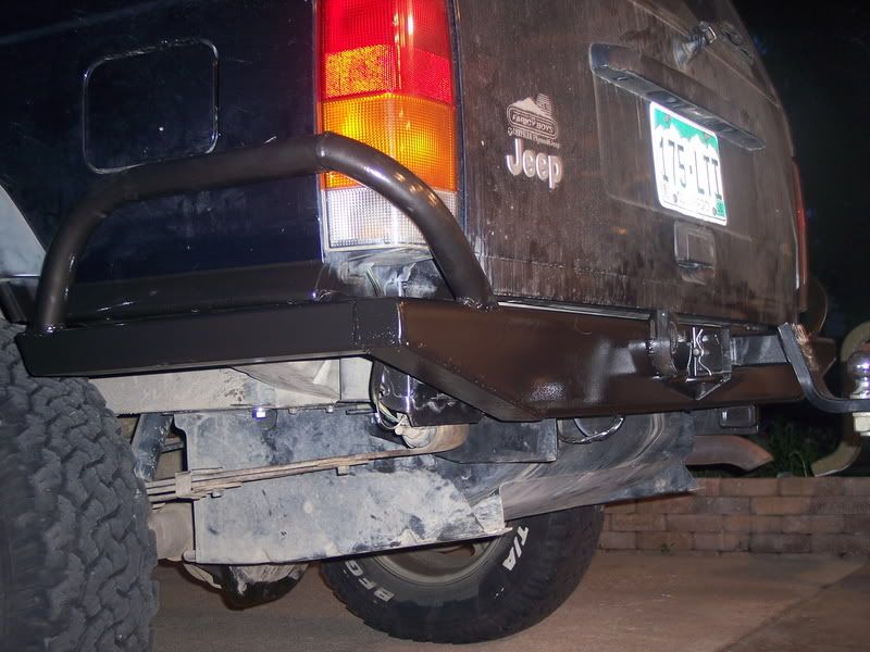

I would also suggest incorporating tail-light protection (see below)
On my home brew rear bumper I did NOT incorporate nice end caps and it bugs me everytime I look at it...and it's my Daily Driver :Wow1: But I DID incorporate tail-light protection and I smile everytime I see it.
I plan to modify the corner to be rounded and match the radius of the tail lights and fill in the gap between the bottom of the tail-light and the top of the bumper.
