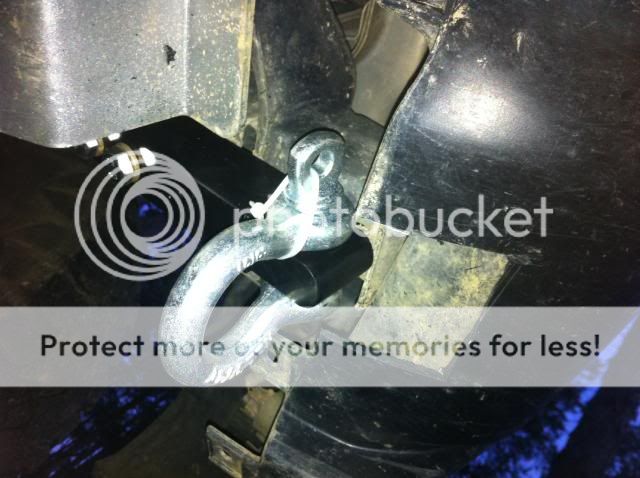

Added some tow points up front from a Jeep made by Rampage.

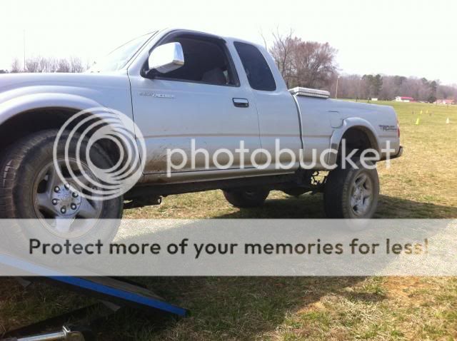

Random rti ramp pics. Order is stock, then stock no sway bar and billys and shackle with no bar.
