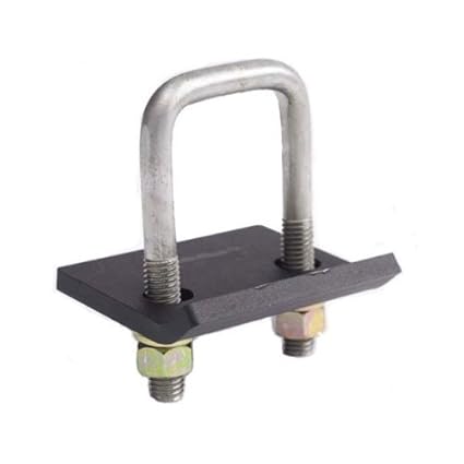

D) Add something like the StowAway:
Figuring with all the movement, the anti-rattle hitch pin may have difficulty staying tight..Those of you with offroad trailers and receivers, how are you keeping them quiet on the trail?

I have the DIY version of the StowAway. Looking at the pic, flip it upside down, angle the u-bolt so the round cross portion of the u-bolt fits in the elbow made by the end lip of the receiver and the receiver body, use the std cross bar for the u-bolt (or 2 of them) across the top of the bar inserted into the receiver, use 2 knobs or even wing nuts to tighten. My setup has been good for over 7 years now.
