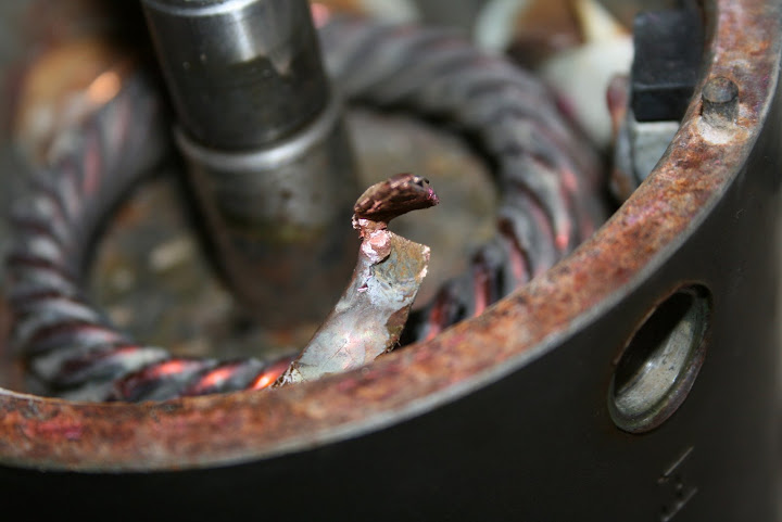

Unfortunately, when I had originally wrenched on the bolt with the motor still attached to the winch I also broke the connection between the copper winding and the bolt head, see pic:
I also broke a bit off the end of the copper winding:

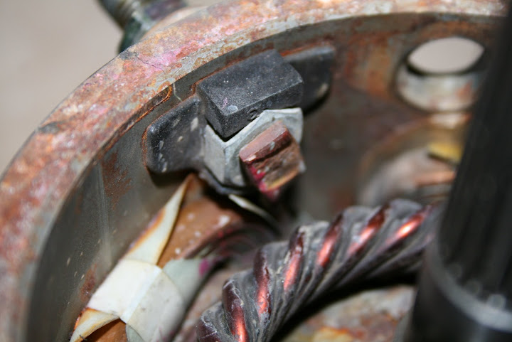

This is what it should look like soldered to the end of the terminal stud bolt:
My intention is to purchase a replacement bolt, insert it, and solder the end of the copper coil onto the head of the new bolt. I will try to bend the end of the copper coil back into place as much as possible but I will most likely try to solder it back together as well.

If you ever really work the winch hard you could raise the stud's temp to the point of melting low temp solder. It shouldn't EVER get this hot, but it can.
So suggestion A would be to crimp an eyelet terminal on the end of the winding lead and capture it under the bolt head. And suggestion B would be to use a high temp solder or TIG/GTAW weld it directly to the stud. Copper to copper welds nice. I've used solid core house wire for filler metal.

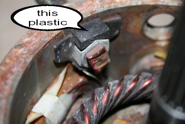

I think the crimp an eyelet terminal was a bad idea.
I did it on my xd9000i and it got very hot on a hard winching and melted down the plastic stud.
I was looking for the part to WARN and they said no replacemet part for the plastic and recommend to buy a new casing. Blaah...
