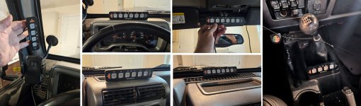

The slim size of these switch panels provides a lot more opportunity for mounting in a typical Wrangler. These are some of the places the 4- and 6-gang panels would fit nicely in a TJ:b

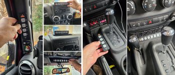

A few possible mounting locations in the JK:

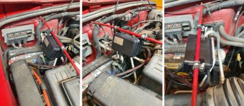

A mounting bracket is provided for the control unit, and it commonly would be used to mount the unit to an inner fender. The control box is typically mounted in the engine compartment. In the TJ, the mounting bracket and control unit fit nicely on the drivers side inner fender:
The one problem with that location is that the heavy-gauge power cables supplied with the kit are too short to reach the battery if the control box is mounted there. But Auxbeam does offer much longer cables for those who might need them: https://auxbeam.com/collections/wir...0-7awg-with-6m-and-8m-tinned-copper-wire-lugs, but I like to mount the control box to the grille support rod using wire clamps. This photo is from the earlier review of the 6-gang system; mounting the control box for these slim systems could be done in the same way and the heavy-gauge power cables will reach the battery easily. There’s a link to that review at the end of this article.
The later model Wranglers don’t really have enough free inner fender real estate to use the supplied mounting bracket, but one place it could be mounted in a JK is to the lid of the factory fuse box. If you do mount it there make sure there’s enough slack in the wires to allow the factory fuse box to be opened, and note in the photo that the control box is slightly over the edge of the fuse box lid – that’s to allow the wires to the control box to exit from the slots in the bottom of the control box housing.

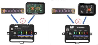

One last thing I tried on the bench – can the switch panels be mixed with different control units? Maybe you’ve got an 8-gang with the rectangular panel and the new slim panel would suit your interior better but you don’t want to rewire all of the accessories? Or what if you’ve got the RA80 X2 unit and you want to use a slim panel on the dash but a rectangular panel in the back near your fridge and other camping accessories? I bench tested and RA80 X2 control unit with a rectangular8-gang switch panel and a slim 4-gang and everything works just as it should.
Auxbeam did tell me ahead of time: “all of our RGB switch panels with 4-pin connectors are compatible with one another” so if you’ve got any of their earlier RGB systems, you can mix switch panels just by plugging them in.

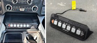

And this just in… apparently Ford aftermarket company BMC Lights thinks they’ll be a hit too – they’re now promoting a custom mount for Ford trucks to fit the 6-gang slim panel. Maybe other companies will join the party and make custom mounts for Jeeps for these new panels:

And they said this about compatibility of switch panels and control units:
Our RGB panels come in two versions. The older version does not have a mode button (it only has a single button), while the upgraded version includes a mode button (dual buttons). Only the dual-button version allows interchangeable use of panels without requiring rewiring or replacing the control box. Unfortunately, the older single-button version does not support this functionality.
They included this image:
