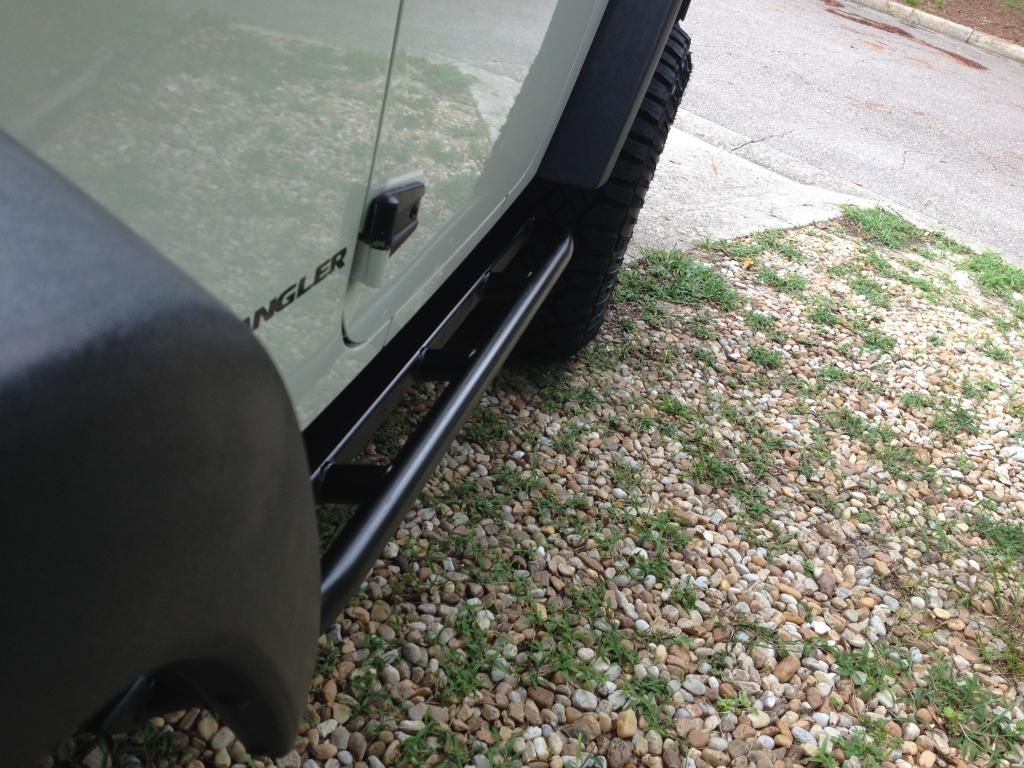

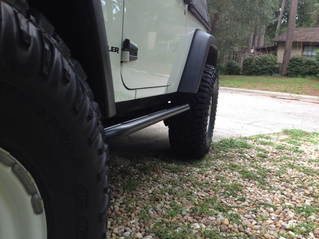

You should also look into white knuckle offroad. They're frame mounted and john offers dom tubing. Good alternative to what some have said about schrockworks taking time to fulfill orders. Here are some pictures of them on my rig. Pretty easy to install too. Took an afternoon by myself.

Those WhiteKnuckles look stout!!
Yea, they are! 57 lbs each, I think. Had them welded as well after I bolted them on. Totally worth the money! And it's a small shop guy, love helping guys like that grow their business.

Do you have any pictures of how and where they are mounted? What is involved?

Here are some pictures of the mounting locations. It's pretty easy to install, just need some jack stands and a jack tall enough to position the sliders in their final mounting place on the frame. There are 3 support beams that mount to the jeep frame. So I think it was like 6-8 holes you need to drill each side, w/the transmission crossbar bolting underneath the sliders, using the existing, threaded frame hole.
You mount them once, mark the places to drill into the frame, remove the sliders, drill and then mount and bolt up. Some of the bolts will shear off if you're like me and have issues lining them up again properly. But I got them welded and they are part of the Jeep forever! If you do get them welded just make sure you tell the tech to not weld the front bottom bolt area, since that is the transmission cross bar and needs to be removable for service, etc.
