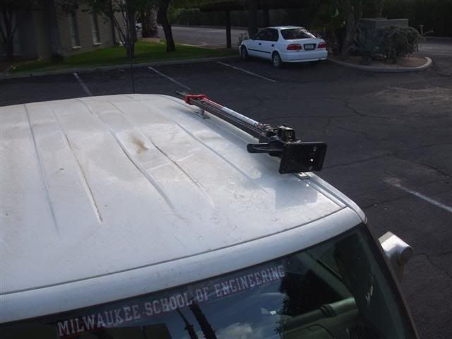

tibaal89
I can't say for sure, but I'm going to guess yes you'll be OK.
I know that I had two adults (including a 300lb man) on the rack-less roof of my FJ and it was relatively fine.... :friday:
So, I'd figure that if this is all that happens under that kind of load in the most ridiculous way possible, then loading it up in a reasonable fashion will totally fine.
