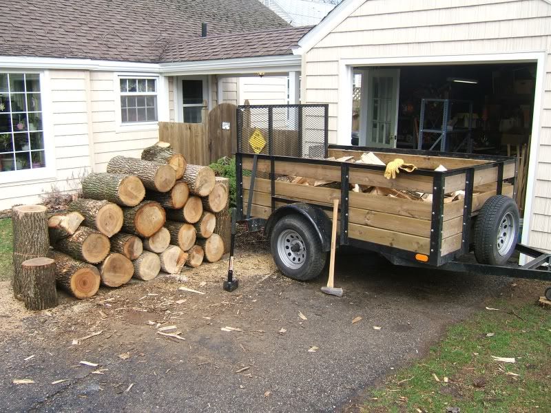

If the little rooftop box is not enough I will look for a smaller trailer. Right now I have a small utility trailer but it sits lot to the ground and I hate dragging it on stuff. I considered modding it but these days I am more interested in buying something made right from day one instead of me messing with things and winding up with old parts sitting around.
