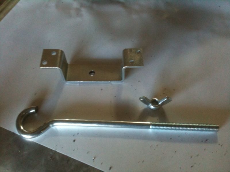

Quick trip to the hardware store took care of it. Couldn't find a J bolt long enough so I bought a eyebolt and cut out a section. that and a bracket that fits nicely in my wheel hole and I am set.
